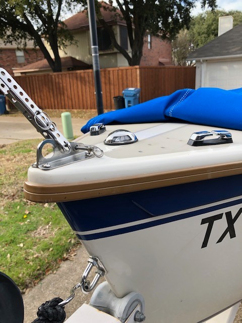

If you're not against running wire and keeping a small gel cell battery aboard... I have one of these tiny low profile LED combination bow lights on my 14' sailboat and intend to put one on my DSII. They are USCG rated, take up almost no space and are remarkably bright and low current draw.

What you are showing in your picture appears to be a dual color bow light and one with a small separation between left/right lens, which would make it fit well if mounted on the foredeck behind the stem fitting. It would work better than pthe typical paired sidelights. Those wouldn't work as well on a DS, because on a small boat, you are supposed to have your lights forward, but the separate light fixtures would seem to require mounting surfaces that are parallel to the centerline (otherwise it messes up the sectors).
Judging from the listed price for the set I could find, this one could be extremely affordable (in fact, the price I saw is suspiciously low), and, being LED, its power consumption would be small enough that you wouldn't need a very massive battery. Might get away with 4 3V Lithium cells in series (I assume these are configured for 12V, but the product details that came up on Amazon are clearly insufficient / wrong). Might be a clearance item - anyway, at that price, the risk would be low - great suggestion.

Yep GreenLake they're rated 12 volt but seem just as bright on a little 9 volt smoke detector battery when I hook it to one.
Here's one mounted just like you're thinking on a 14' sailboat in my fleet... never gets caught on the jib, docking lines, etc.

nice.
I know s Some LEDs have voltage regulators, but usually LEDs are sensitive to below nominal voltage. If these work with 9V that would make them super convenient.
