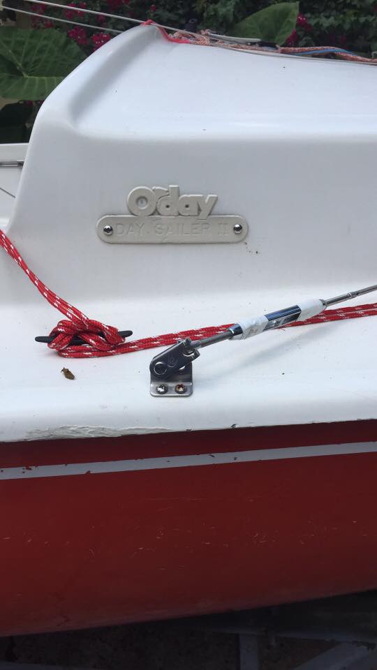

DS I or DS II? I presume DS II because posted in the DSII Only sub forum. On my DSII, if I am looking at the O'Day logo on the cuddy, I can go to the center of the logo and then straight out to the edge of the boat, and the chainplate is located right there.

DM, what's the red line around the horn going to?

Shagbark wrote:DM, what's the red line around the horn going to?
That is the tie off for my jib downhaul. When it is down I tie it off there. When the jib is up I tie it off at the mast. It creates a lift that helps the jib sheet cross over on tack/jibes, preventing snagging.

Postby TIM WEBB » Sun Jun 26, 2016 10:25 pm
DM, why the double line for the jib DH?

Yep I could not afford a spinnaker, so downwind I just fly the new and old jib at the same time, one on each side of the boat. I also installed little wings on each side with flaps. With enough breeze the boat comes out of the water and turns into a seagull. :shock:
Just kidding ;) In that picture the boat is sitting on the trailer in the driveway. Both ends are tied off there for storage because it is not in use/rigged. When the boat is rigged, one of the ends is lead fore through a micro block by the stemhead and then attached to the jib. When the jib is up, I clip it off on the mast. That allows tacks/gybes to lift the foresail up and over the section of calamity on the mast where things like to snag. When the jib is down, I tie it off on the horn cleat by the starboard chainplate, and throw the excess into the cuddy.
