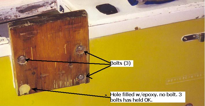

I use a 4hp long-shaft Johnson (2001 model) originally I had it clamped right to the transom and that works fine, except the transom slopes the wrong way. So, I added a plywood motor board fro mthe previous owner's motor bracket, shimmed to correct the angle. This is secured by 3 bolts through the transom (no access for forth bolt, but in forward, the lower edge of the board is pushed against the transom by the motor's thrust anyway and I hardly ever reverse.
One trick to improve steering and directional control under power is o lower the CB about 1/3 or so. That gives the boat some grip on the water and along with the rudder make it easy to steer straight even with a crosswind.
4HP is all I'll ever need, I'd say 5 is max I'd ever suggest. 2-3 HP is mostly plenty of power if the motor has the right prop. I tried a 1984 2hp Johnson and it worked pretty good, better than the 1992 2.3hp Johnson that I had. Both were short-shaft (15" transom height) and that will work, but a long-shaft (20' transom height) keeps the prop submerged better in waves and powerboat wakes (or if someone goes up to bow while underway). I bought the 4 hp because it had a neutral clutch and is setup to use either the built-in fuel tank or a remote tank. It also has better vibration damping than typical outboards of that size or smaller.
