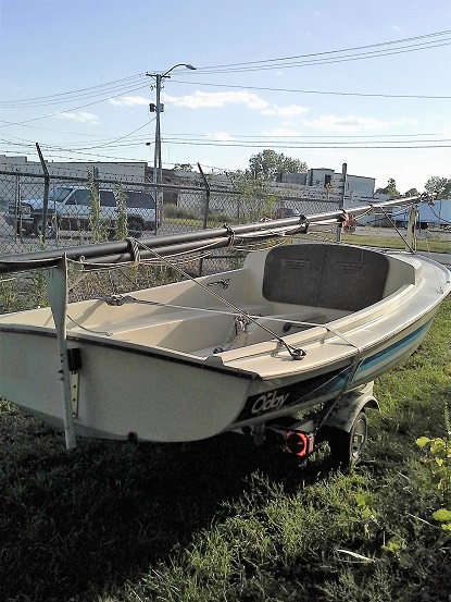

This is how my '83 DSII was when I picked her up. Towed her all the way from Traverse City, MI to nw Ohio behind a Jeep Grand Cherokee. No problems at all. The stern support is a cut-off boat oar in the rudder bracket. The boom is lashed to the mast with bungee straps. The mast is held down with several turns of a dock line tied off to the aft deck cleats. Mast is still straight as a rail. Survived a lot of road construction! hth, John
