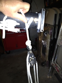

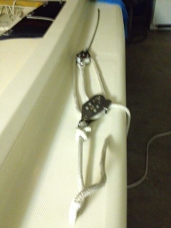

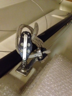

Thanks for your comments. I included three photos of the boom vang in this post. Figure 1 shows me holding it next the the bail on the mast where it was tied to. Figure 2 is a photo of the entire boom vang. The end with the wire attaches to the boom, and the end with the rope attaches to the mast, Figure 3 is a photo of the fiddle block with V jam.
Keith

As such, there's no problem with using a fixed bail on the back side of the mast. It's a common alternative to having an eye strap on the forward side. Cam cleats might work better than the V cleat.

Attached is a picture of my boom vang attachment. My vang is original to the boat. It is attached on the mast end by a line running thru the loop riveted to the front of the mast. I add some cable protector to the cable to where it attacheds to the boom
