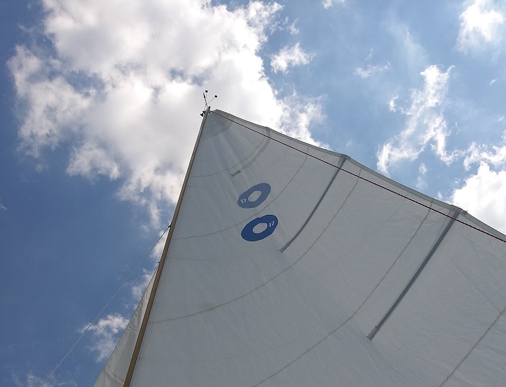

Sail insignia from actual sail

New Main and Jib are bigger than the originals that came with the boat. I did not measure but i could tell while i was rigging yesterday. longer luff and foot.

Go to the DSA website at https://daysailer.org and look under bylaws, section 3 for the sail dimensions. Are those O'Day 17 ones larger than those measurements? If so, they would not be from a DSIII but from some other boat.
I haven't been able to find actual references for an O'Day 17 as distinct from a DaySailer, but O'Day did build multiple models in the same size range, like the Rhodes 19 and the O'Day 19 and these may not have had identical rigs, as DS1 and DSII (and DSII).
If the sails are oversize, it may not be possible to tension the luff enough. What's the verdict?

Verdict is that in unfavorable light and variable wind they worked. I'd say from observation and with the help of my pops critiquing the sail trim they are a good fit maybe not the best. Nice tension on the luff and there's about a 1in left at the foot when tensioned on boom.

I have no reason to doubt your conclusion so far that the sails aren't oversized, and will work fine for you, but you'd need a bit more wind for a full confirmation. When you put full outhaul and halyard tension you'll see whether there's enough mast and boom there to accommodate the stretch. (My new sails were a bit larger than what was on the boat originally, so I changed from a shackle to a knot for the main halyard to make sure to get maximum hoist, for example).

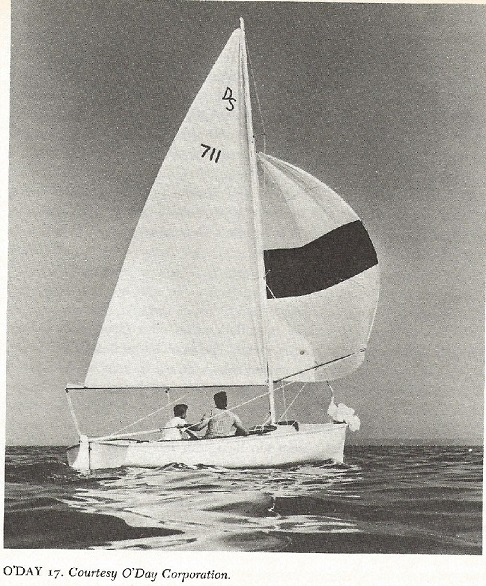

If these sails came from an O'DAY 17 ,and yes there was such a class many years ago, the specs that I have seen for the O'DAY 17 list sail area as "160 sqft" and hte DS (I, II, or III) have 145 sqft of sail area. So, they may be larger than DS sails. Funny thing is, all hte pictures I've have seen of the O'DAY 17 have the Day Sailer logo on the sail...........?
Basically, the O'DAY 17 was configured as Uffa Fox originally designed the Day Sailer, with no cuddy, picture a 1960's Javelin, but built on the Day Sailer hull. George O'DAY added the cuddy to the DS against the wishes of Uffa Fox.
