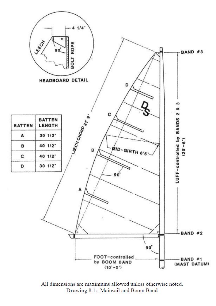

what you posted is just a form that the class measurer fills out (with enough reminders to be able to spot a measurement out of range). It does not give the actual definition of what is being measured, nor the measurement procedure. For that you need to consult the class bylaws on measurements.
Here's a drawing from that document giving the dimensions for the main:
Drawing 8.1 from DS Class Bylaws

GL - thanks for sending through the link to the class by laws on sail measurement which is exactly what I was looking for. Includes pictures... always helpful :D
Didn’t understand mast bands / measurements on the bands either, see that picture also.
Good info!
Re: sail measurements, please
PostPosted: Mon Oct 21, 2019 11:01 pm
Bands: rather than defining the size of the cloth, the rules define how far you are allowed to stretch it along mast and boom, that is, it has to be kept inside the bands. By marking the bands, competitors can be assured that nobody uses a larger sail (if they did, it could not be stretched flat, which isn't fast).

GL - OK more good information and I now understand the bands and see how bands would be necessary to establish the one design sail measurement standards.
To apply bands & to measure the main sail off the boat would I mark out the bands' measurement points (foot, luff, leach) on the floor and stretch the sail to those points? If longer than the marked points then the sail is not legal? If shorter than band measurement point sail is OK but just not as competitive ?

If you and I were sitting around a table, or on a phone having a conversation on this topic it would have taken less than a minute to resolve, maybe two minutes. On an Internet forum questions and answers sometimes are hard to interpret in context or the questions / answers seem to take a life of their own... the answer was in the diagram you posted... Luff 20' 6", Leech Chord 21' 9", Foot 10'
