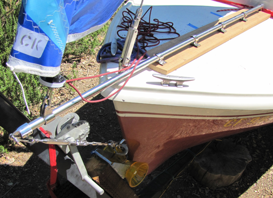

Thanks, K.C. That's a really good idea. I've been pretty much baffled by the problem.
And the bowsprit...
bowsprit installed.jpg (239.03 KiB) Viewed 35680 times

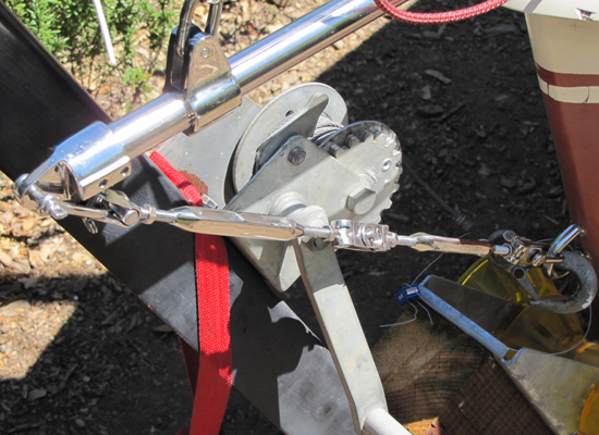

...and the bobstay, which is made up of two turnbuckles and two long D shackles.
Gonna have to to do something about the winch stand - maybe move it forward on the trailer tongue.

Nice setup!
Can't tell from the pix: what keeps the sprit from swaying side to side?

Tim,
Thanks. I'm a hopeless sucker for retro-looking hardware.
The bowsprit tubing (7/8-inch stainless rail), is pretty stiff, and it's anchored at five points on the foredeck. Those four loops on top of the wood are rail slides. At the aft end, just behind the wood, is a rail end bracket. All five are secured through the foredeck by no. 10 screws. Underneath, there are reinforcing plates of 1/4-inch ABS. I've grabbed and tugged at the rail a few times, and it feels pretty solid. I had in mind that someone might grab it as an emergency handle, and I think it'll work for that.
The tubing itself flexes more than I'd like (if I had it to do over again, I'd use 1-inch), but I tried inserting a length of 1/2-inch metal electrical conduit, wrapped with electrical tape. The flexibility disappeared. I'm thinking of using the same conduit as a permanent inner reinforcement, but sprayed with Plastidip.
K.C., how's your bowsprit doing in that regard? My next chance to sail will be in mid-September and that will probably be it for this year, so any advice will be appreciated.

My bowsprit has worked as I had hoped it would. There is a bit of flex to leeward when close reaching under full load but not enough to worry me.

Ah, I see. Didn't realize it was through-bolted. Obviously, the bobstay/luff wire offset any up/down movement. Slick design!
