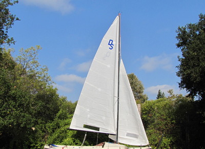

I did a test fit of the sails this morning. Yep, they're for the right boat.
