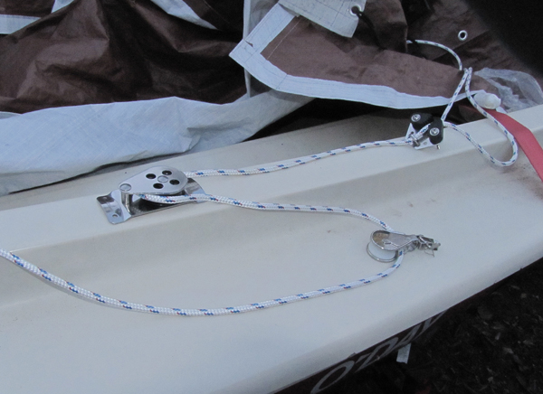

Postby Alan » Mon Jan 21, 2013 10:00 pm
This is a tentative setup of blocks and cleats for a Doyle Utility Power Sail. The bow is to the left in the photo. The cheek block on top of the coaming is a stand-in for an autoratchet block.
tentative UPS sheet blocks.jpg (181.88 KiB) Viewed 27014 times
Thanks once again for the advice, gang.
I've been mulling over Chris's and K.C.'s solutions. Does this look workable to you guys? In the photo above the bow is to the left. I've set up a swivel block (coincidentally, the same brand and model as Chris's and sourced from Duckworks) and a cheek block and a cam cleat and some line, all left over from abandoned ideas.
The swivel block is set up almost the way I read Chris's description, but outside the coaming instead of on top of it.
The cheek block is a stand-in for an autoratchet cheek block because I don't have them yet. I'm thinking of Ronstan 57 mm, or maybe Harken 55s because the ratchet release load is adjustable.
The cam cleat is maybe overdoing it, but I've got two of them already, so what the heck.
The line is 1/4-inch Sta-Set because I happened to have it, but my creaky fingers are definitely leaning toward 7 mm Bzzz.
And I want to make the Dyneema soft shackle just for the fun of it. Still got to pass the time until April...
I'm hoping to keep lines out of the cockpit for now, partly because there's less of a tripping hazard and partly because there will be two to four people in the boat. Seems to me that this setup will do that, and also give a 180-degree turn around the autoratchet.
Make sense?

Postby K.C. Walker » Tue Jan 22, 2013 12:17 am
My UPS is cut to be sheeted at the spinnaker turning blocks, near the transom. When I was discussing this with Josh from Doyle, he said that was the standard set up. They did a great job and the sail sets just right from that position. I bring the sheet forward from the turning blocks to a block on a second car on the jib sheet track.
I haven’t decided about cleating. So far, I haven’t cleated it, which is why I like the rachet blocks. I do sometimes snub it off by wrapping it either one half or a full turn around a horn cleat, though. This seems to work so far.
For me, your cheek block location looks to be the premium hiking out location which I would find to be a problem.

Postby Alan » Tue Jan 22, 2013 12:43 am
Hmmm. The sheet cleat location didn't come up when I talked to Paul from Doyle in New York - our conversations were mostly about luff and foot length.
I see your point about hiking out - the block location in the photo is right about where I'd be sitting to have the mainsheet in hand. I should probably move the turning blocks aft.
Are your autoratchets the turning blocks, or the second blocks on the jib sheet tracks?

Postby K.C. Walker » Tue Jan 22, 2013 12:51 am
The auto ratchets are on the aft deck which gives the 180° wrap and are swivel style.

Postby ChrisB » Tue Jan 22, 2013 8:01 am
Alan,
Does your boat have the stern cleats? If so, before I drilled any holes, I would tie a 24" piece of line to each of the Race Lite blocks and experiment with placement of the the turning blocks that best suit your UPS. Since I had mine cut like a light air genoa, my blocks are further forward than the standard location for a spinnaker block. Also, it looks like the cam cleat in your setup would require pulling the UPS sheet aft to engage it in the cleat. If you are going to be close or beam reaching with the sail or if you sail solo, you will want to be able to cleat and uncleat it from the windward side of the boat. Since I don't roller furl mine, to douse the sail I head downwind, lock the tiller, and gather in the blanketed sail from under the boom. I wanted to minimize the number of blocks and fairleads the sheet passed through to minimize the opportunity to foul the sheet while I was taking it in. If you plan to roller furl yours, that's less of a concern.

Postby Alan » Tue Jan 22, 2013 3:13 pm
Chris,
Good point about the stern cleats. I did a lot of measuring before I ordered the sail, but it was focused on luff length, with foot length as a byproduct. It looks like I'll have to wait for the sail to show up, then hoist it and make things fit. I do have stern cleats, so attaching the aft blocks to them sounds like an ideal way to figure out the permanent location.
