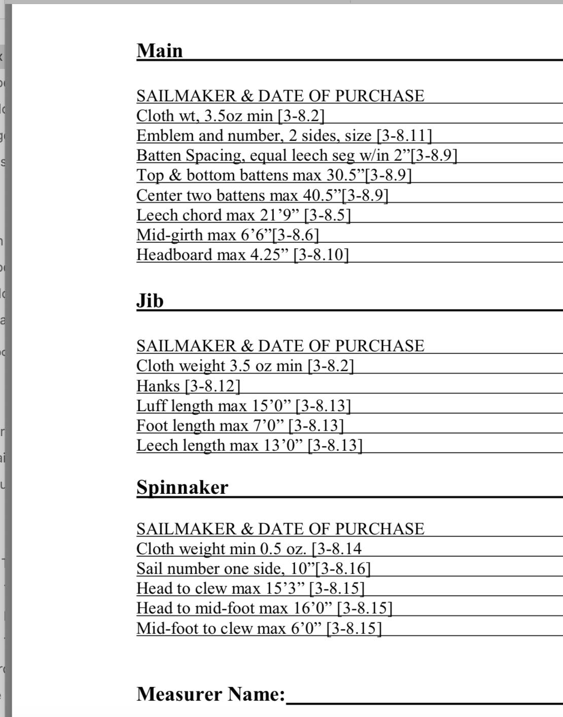

So I was looking at the Day Sailer Sail Inventory Measurement Certificate page of the DSA Measurement Certificate, looking for the "official" main, jib, & spinnaker sail measurements, and found the attached measurements which I captured with a screen shot.
Wanted to measure the sails I already own to see if they would meet DS rules.
Thought that Main sail would have a luff, foot, and leach measurement like the jib does; but don't see that here. Spinnaker measurements are pretty straight forward also. I don't really understand the measurement categories provided for the main sail. Going to have to look for a picture of those items and then try to sketch them out
Are there main sail measurements (luff, foot, leach) in addition to those listed on the certificate?

what you posted is just a form that the class measurer fills out (with enough reminders to be able to spot a measurement out of range). It does not give the actual definition of what is being measured, nor the measurement procedure. For that you need to consult the class bylaws on measurements.
Here's a drawing from that document giving the dimensions for the main:
Drawing 8.1 from DS Class Bylaws

Postby RobH912 » Mon Oct 21, 2019 10:48 pm
GL - thanks for sending through the link to the class by laws on sail measurement which is exactly what I was looking for. Includes pictures... always helpful :D
Didn’t understand mast bands / measurements on the bands either, see that picture also.
Good info!
