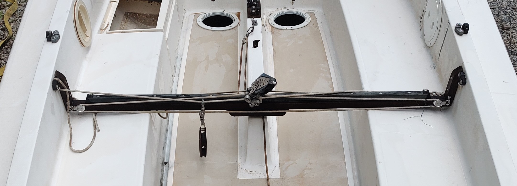

First - it seems that a previous owner built and installed this traveler athwart the centerboard trunk, so evidently, he revised the main sheet rigging from the factory standard.

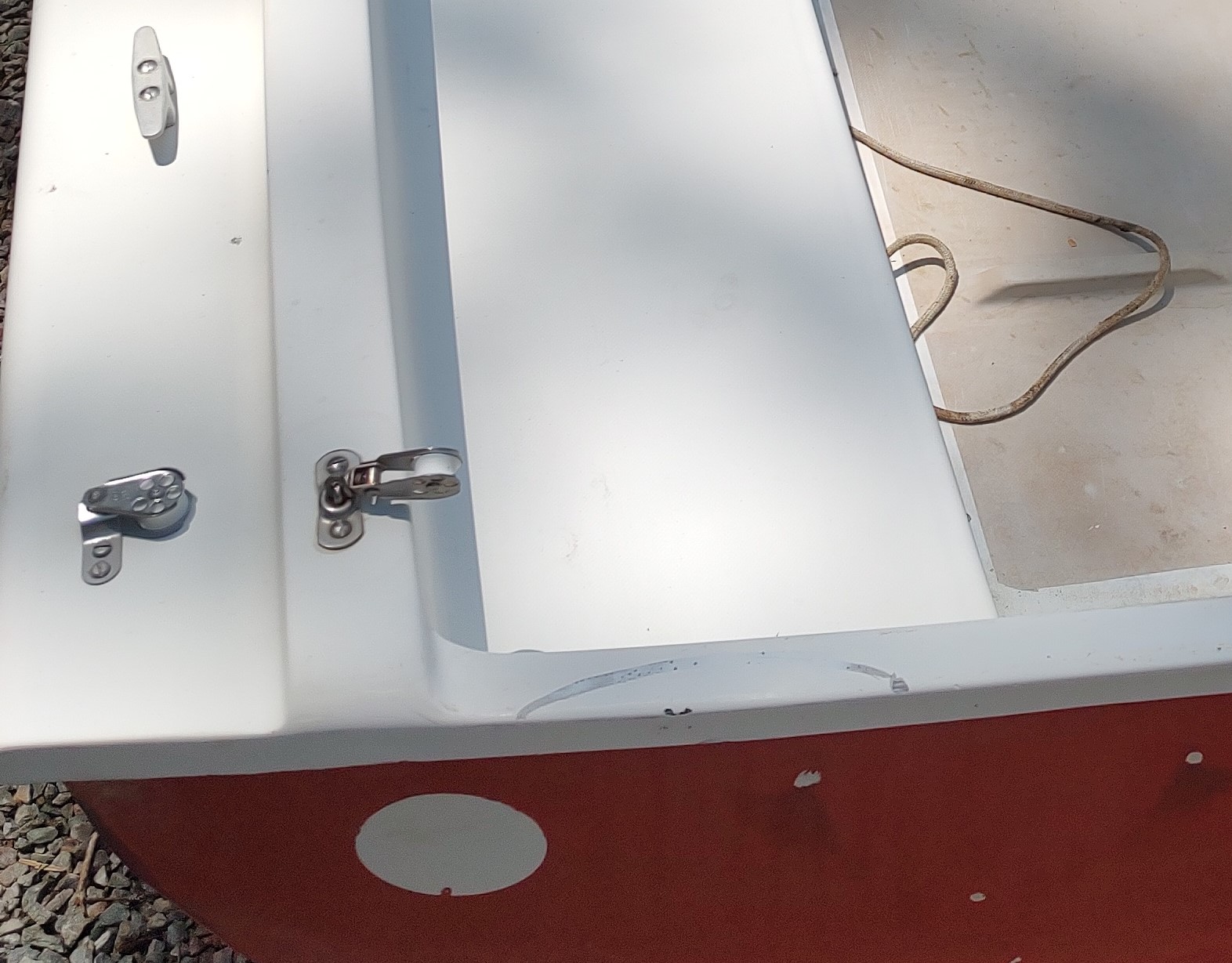

Right at the aft end, on both sides, there are these small cheek blocks, two on each side:
aft cheek blocks.jpg (347.55 KiB) Viewed 8754 times
I'm thinking that these were used for the main sheet in its original configuration, and perhaps they are no longer used, since he re-rigged the main sheet ... ?

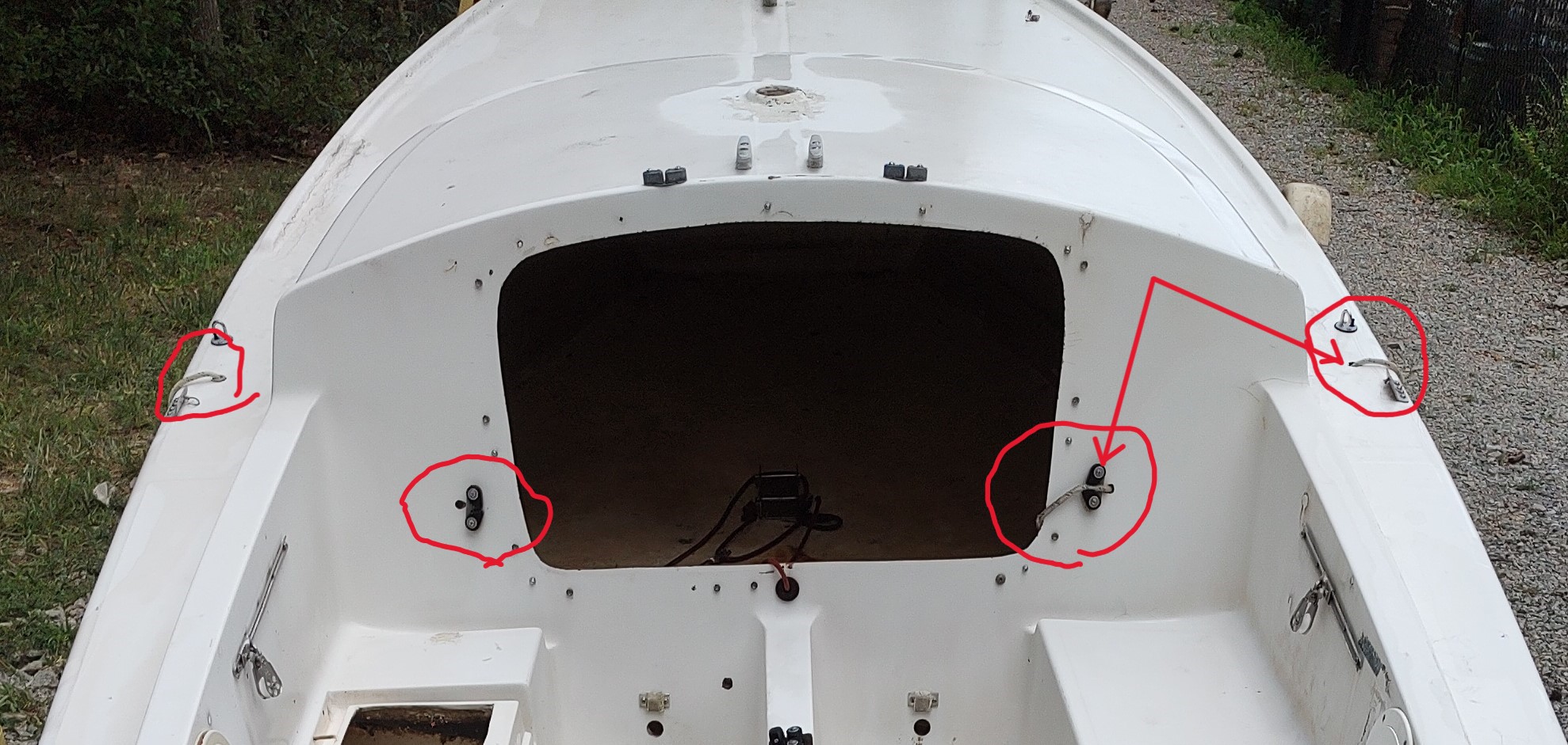

Next up are these mystery lines - one on each side, passing through a hole in the side deck right next to the cabin, passing into the cabin, and then through a hole in the aft bulkhead of the cabin, and to a cam cleat - I have circled them in red:
unknown lines.jpg (446.06 KiB) Viewed 8754 times

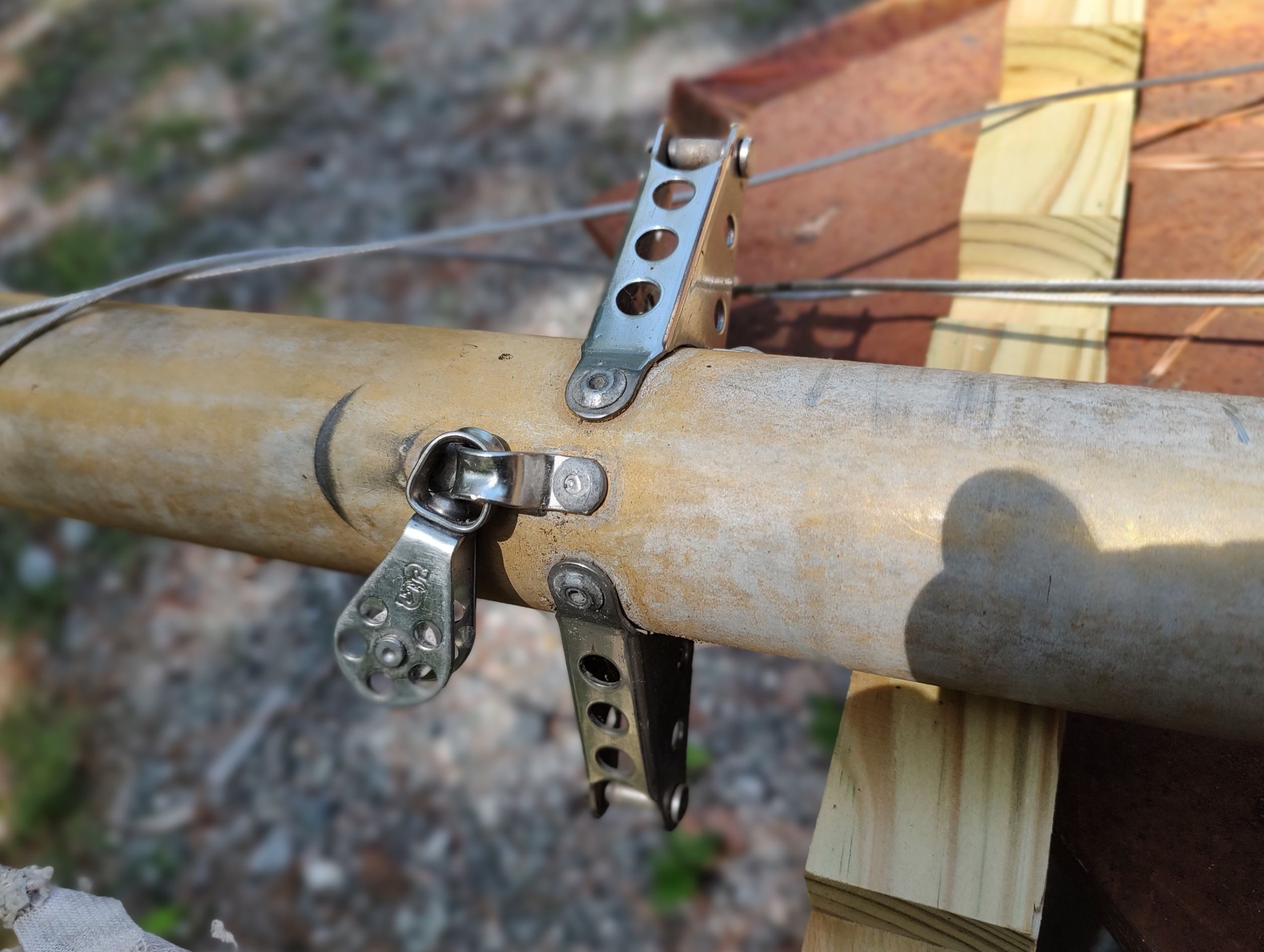

mast head.jpg (431.23 KiB) Viewed 8753 times

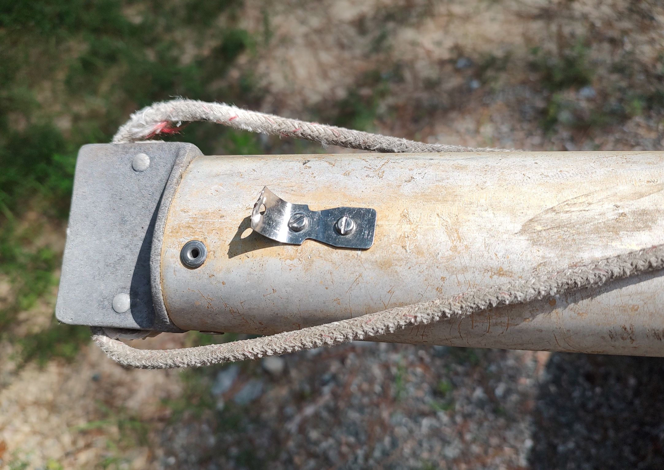

mystery tang.jpg (494.95 KiB) Viewed 8753 times
Don't know what that might have been for. Broken mounting bracket for a windex?

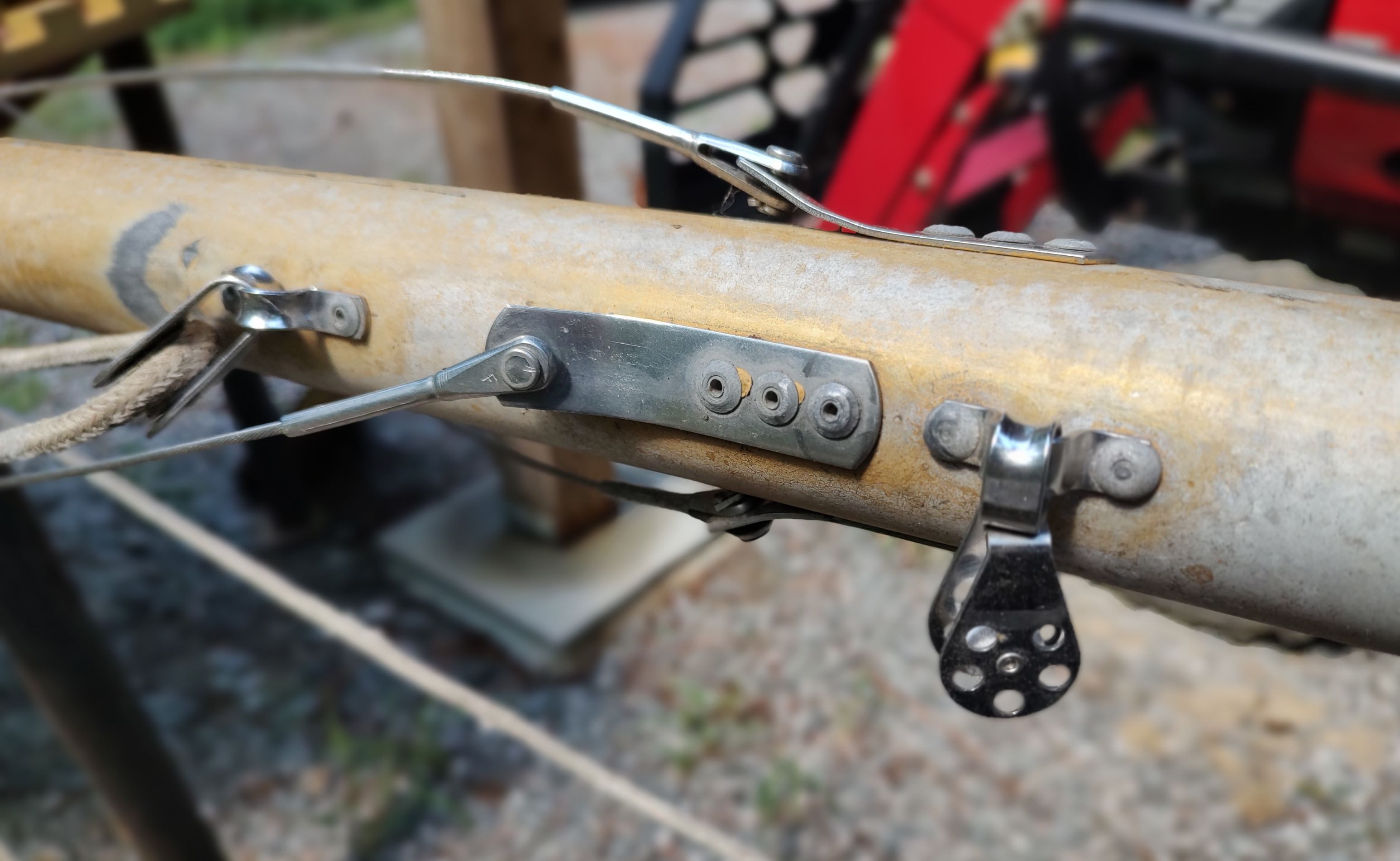

And then, farther down the mast, there are a couple small cheek blocks - one is located right near the tangs for the shrouds and forestay, and one is located right near the spreader hounds.
mystery block 1.jpg (391.96 KiB) Viewed 8753 times
mystery block 2.jpg (413.26 KiB) Viewed 8753 times
Don't know what those might have been for.

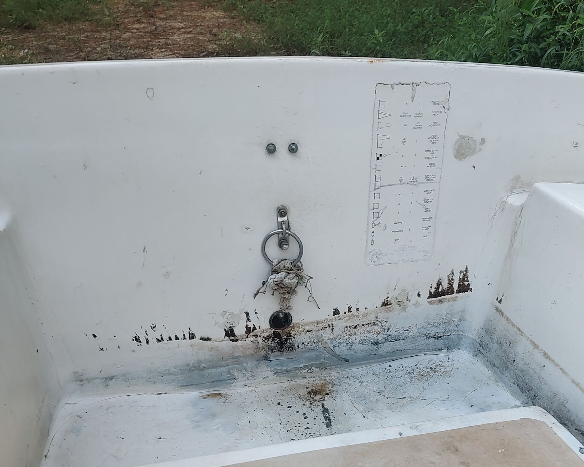

Finally (for now), I'm assuming that these two mounts in the cabin bulkhead might be the vestiges of hiking straps? And they would have attached to this ring at the transom?
hiking strap mounts.jpg (338.09 KiB) Viewed 8753 times
hiking strap mount aft.jpg (282.65 KiB) Viewed 8753 times
I greatly appreciate any helpful info and insight anyone can lend! Thanks!

BillT wrote:First - it seems that a previous owner built and installed this traveler athwart the centerboard trunk, so evidently, he revised the main sheet rigging from the factory standard.
This forum allows only four photos per post, so I will continue in the next reply to this.
That limitation is useful, it's much easier to respond in a focused way to just one hardware item.
That traveler seems to be a fine piece of kit. I would replace the control lines and the mainsheet (if either set is halfway serviceable, you can postpone that until after your maiden voyage). If you find, after sailing the boat, that the traveler is in the way, you can always change either back to the original Crosby rig, or keep the center boom sheeting, but add a powerful van for vang sheeting.

BillT wrote:Right at the aft end, on both sides, there are these small cheek blocks, two on each side:
Not a bad guess. The two standup blocks, the inner pair, so to speak, are indeed most likely for an original traveler in end-boom sheeting. You can remove them, if you feel like it, or leave it until you're sure you like sailing with the traveler.
However, the second (outer) pair of blocks are most likely for the spinnaker sheets. Your boat seems to have been set up for the symmetric spinnaker. See "How to Rig and Fly a Spinnaker".

BillT wrote:Next up are these mystery lines - one on each side, passing through a hole in the side deck right next to the cabin, passing into the cabin, and then through a hole in the aft bulkhead of the cabin, and to a cam cleat - I have circled them in red...
First, what you haven't circled. These are special hooks that you can hook the spinnaker guy through. You may know that, but just in case and for anyone curious about, but not experienced with symmetric spinnakers: the spinnaker has no tack, but two clews. These are each connected to a line lead aft to the blocks you found. The leeward one is used just as you expect, and called "sheet". The windward one is called the guy and is first lead through a jaw on the spinnaker pole, then hooked through that little hook, and from there to the block at the stern. The little hook changes the angle to be more downward, which helps the guy do its job which is to control the angle of the spinnaker pole.
At each gybe, the pole is brought over and the role of guy and sheet are switched. That's the reason you only have a hook for the guy and not a fixed eye, because you need to unhook it when it becomes a sheet.
The two mystery lines are called "twings". They should end in a ring through which the spinnaker sheets are lead. You can use them to pull down on the sheets a bit to make for a better angle. Booth the hooks and the twings are some of the more "advanced" spinnaker controls. If you are new to flying a spinnaker, you can get by without them, but after you have the basics down, you might want to experiment to see whether you can get them to work for you.
I would not recommending removing them, definitely not the hooks. I would recommend you try out a spinnaker, if your sail inventory has one, or even go out and get one, if not. If you don't have a spinnaker pole, you an make your own.
All this hardware makes it look like the boat was sailed by someone serious. If you don't already have the experience/knowledge, just leave some of the advanced controls alone at first, but trust me, it'll be more fun over the years to figure out how to use them and to get good at it. In the meantime, here's a recap of which controls are the most basic ones.

BillT wrote:At the head of the mast, there is a small cheek block, which I'm assuming they added for a topping lift, which makes perfect sense; at least that's what I intend to use it for. But on the other side of the mast, there is a small tang of sorts, possibly broken?
Yes to both. Windex mount is likely, but mine looks different. However, there are many models. Remove and add mount for your Windex.

BillT wrote:..farther down the mast, there are a couple small cheek blocks - one is located right near the tangs for the shrouds and forestay, and one is located right near the spreader hounds.
First, these are not "cheek blocks". A "cheek block" is one mounted flush to the surface, like the one for the topping lift. These are all ordinary single blocks that are attached to eye straps. With and without a swivel.
The one above the forestay is for the spinnaker halyard, the one directly below is for the jib halyard. The lower one is for the spinnaker pole uphaul. I don't have a block there on my boat, because I'm using a bungee for an uphaul, which adjusts itself based on tension in the downhaul. Even if you like to follow my way of rigging the pole, you can keep the block, because most likely you'd want to double a thinner bungee anyway to get the right tension, so you could just loop through it.
Unless any of them are stiff, even after rinsing and perhaps using a bit of dry (!) lubricant, I would not automatically replace them.
The spinnaker one has a swivel, which is important so any twist in the sail doesn't twist the halyard.
Re: Help identify hiking strap mounts
Postby GreenLake » Sun Jul 20, 2025 9:25 pm
BillT wrote:I'm assuming that these two mounts in the cabin bulkhead might be the vestiges of hiking straps? And they would have attached to this ring at the transom?
My assessment as well. It corroborates the evidence that this boat was sailed by someone serious.
Re: Help identify traveler
Postby BillT » Mon Jul 21, 2025 5:18 pm
GreenLake wrote:
BillT wrote:I would replace the control lines and the mainsheet (if either set is halfway serviceable, you can postpone that until after your maiden voyage).
The few lines that remained were in extremely rough shape, so yesterday, I ordered replacements for everything - main sheet, jib sheet, main halyard, jib halyard, boom outhaul, cunningham... I'm feeling pretty unhesitant in spending money on this boat, since I got it for free. :D

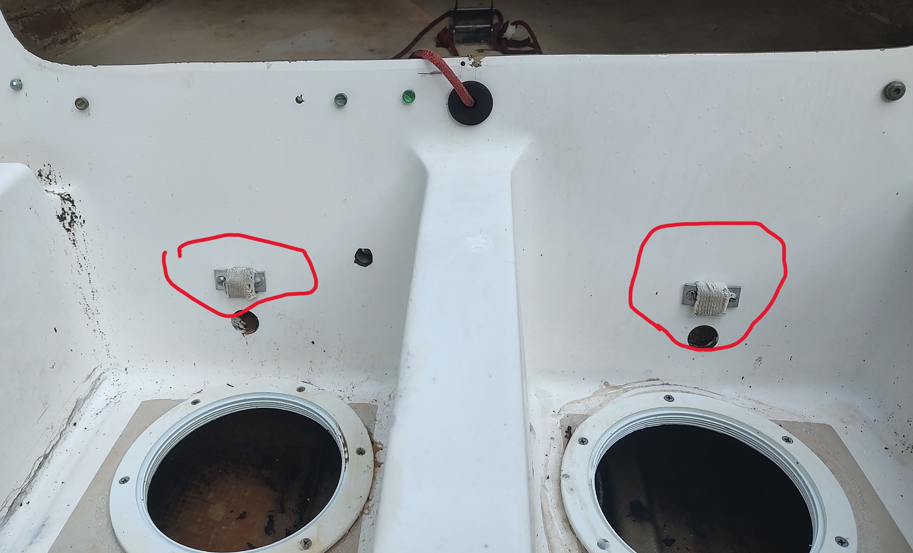

GreenLake wrote:The windward one is called the guy and is first lead through a jaw on the spinnaker pole, then hooked through that little hook, and from there to the block at the stern.
And then ...? To a cam cleat somewhere? There are two of them on the coaming - one on each side, just ahead of the traveler, and I have yet to determine what they were for. Perhaps for the spinnaker sheet and guy?

Postby GreenLake » Mon Jul 21, 2025 8:32 pm
I think you found the cleats. I fly my spinnaker a lot in not very strong winds and don't rely on cleats very much. Usually, you would cleat the guy more than the sheet. Read the thread I linked, to fly the spinnaker is different from flying a jib in that you generally adjust the sheet continuously to where the luff of the spinnaker (whichever edge is more windward) just slightly curls.
