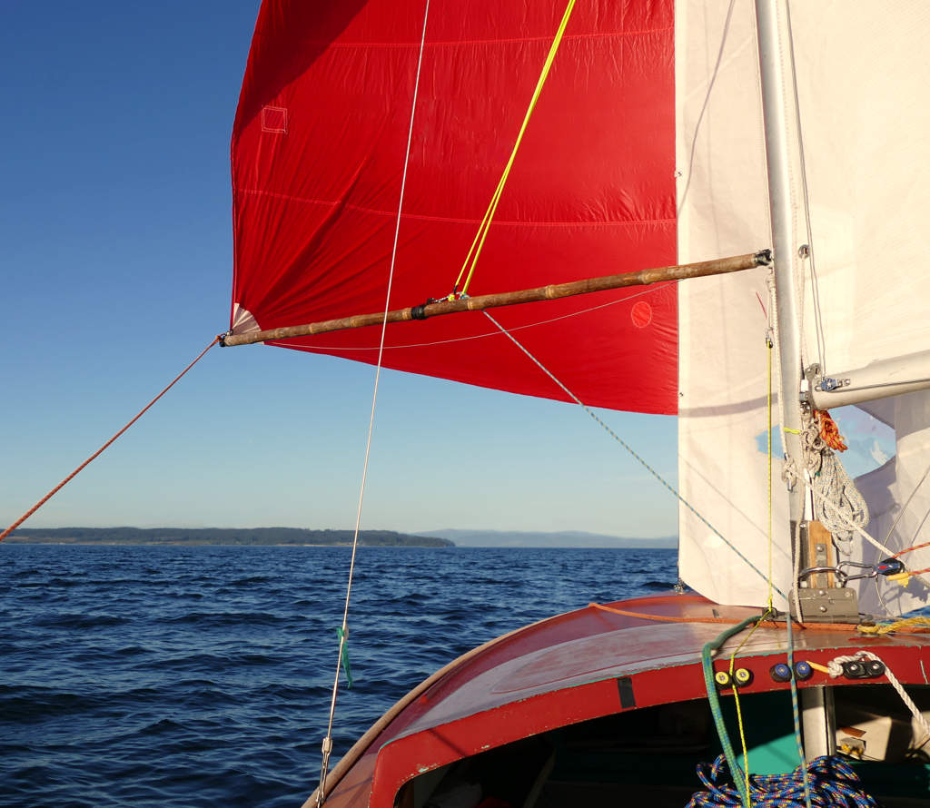

A number of years ago I made a spinnaker pole from bamboo. It's been holding up nicely, here it is in action during an excursion this summer.
Bamboo spinnaker pole
Here is the description of how I put it together.
I did that originally as a quickie because when I got a hand-me-down spinnaker, I wasn't sure whether I would like to make it a permanent addition. That was years ago, the pole is still in regular use (as is the spinnaker). I found the pole good & strong to the limit to which I am prepared to fly my spinnaker.
I found it cheaper and about just as strong and durable as one made from aluminum -- but lighter.
A whisker pole could be built along the same lines.

Forespar produces two lengths of these, if the model number on the West Marine site is correct, they sell the 84" version. That's a bit longer than you need, so you'll have to cut down the pole to measure.
I'm sure this is quite functional; but several times more than I paid for my setup.
One small difference. They use a bridle setup to attach up/downhaul. Technically, that's the correct thing to do, because that way you don't put any bending load on the pole. I usually don't fly my spinnaker at the top of it's wind range, and have not seen any bending with my setup that would concern me. But it's a simple change, if I ever thought it necessary.

The one you see pictured is the one I built and have used for multiple seasons.
I bought it for $5 locally, from a store in my neighborhood. Not sure what they specialized in, as they have since closed or relocated. I cut a strip of glass cloth (you could also use ready made tape) and wrapped it in a spiral pattern and coated with a bit of laminating epoxy and then PU varnish to cut the UV. That increased the effective cost a bit, slightly more than doubling it, I think.
It's still cheap compared to aluminum and the coating protects it from weathering and prevents cracking or splitting. It feels lighter than an aluminum pole and has held up well for me.
The trick is to find a bit of bamboo that has the correct diameter and is close to perfectly round as you can get. Minor unevenness can be overcome with a bit of epoxy paste when you bed the end fittings, of course, but it's best to start with a good fit.
