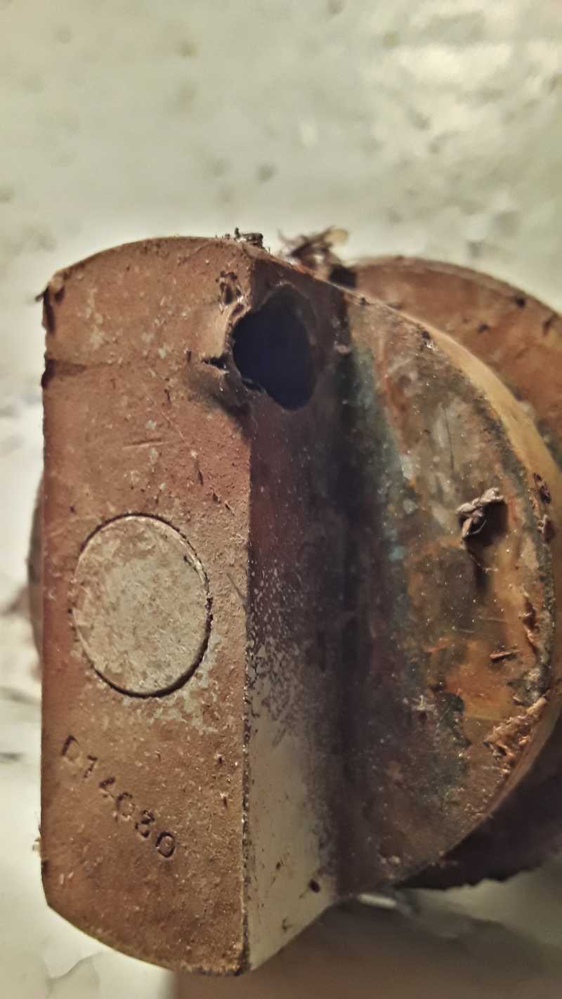

I am fixing up my old '59 DaySailer and have a question about how the mast jack mechanism is supposed to be attached. I have only had the mast raised and in use once which was a couple years ago before our world became very interesting. So I don't recall exactly what was going on around this piece, but I am pretty sure it was not as loose and flopping around as it is now.

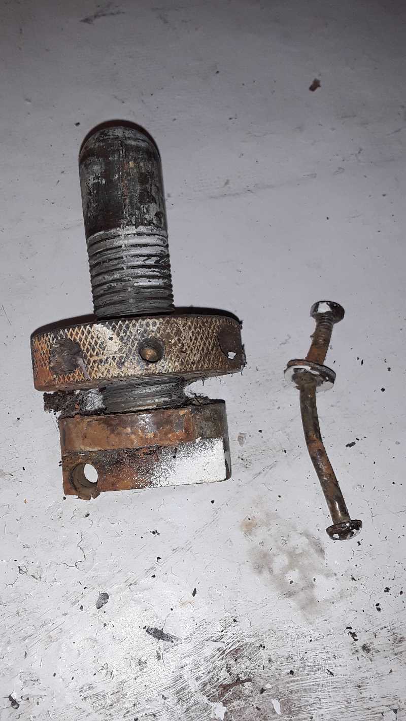

I can tell that the pivot bolt it attaches to has been bent from years of use so I am sure that I have to replace that, however even once that is replaced I am questioning if there should not be more support under the jack itself. It would seem that little bolt is not strong enough to support all of the downward force of the mast and shrouds. When I move the jack out of the way I do not see any kind of backing plate or block of wood that it would have rested on so I am a little puzzled. I am waiting for my new Dremel tool to be delivered so I can cut the bent bolt out of the way and then perhaps I will be able to see better under the housing.
Looking through my phone gallery I guess I forgot to take a picture of it, but I did record this video to show what I was looking at. Would love any additional information on how this is supposed to be configured. Sorry for the shaky camera work :wink:

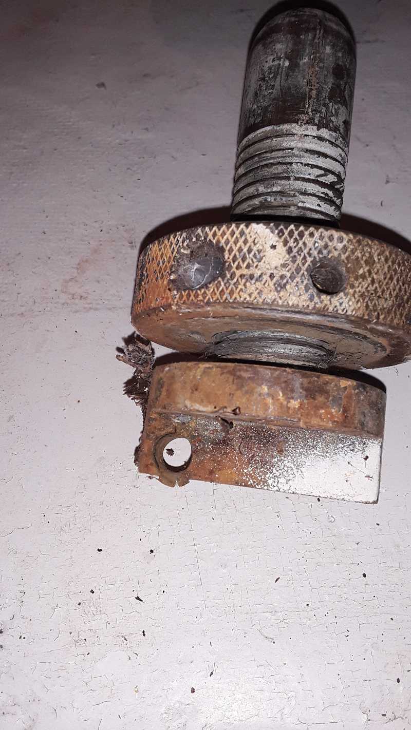

I was able to pull the bolt out last night and get a better look at it. There is definitely something missing. I agree that this setup looks like it should slide to adjust mast rake but there is just one single hole and an empty void under the keelson. And because it has been used in this configuration for what I imagine is quite some time the bolt has caused damage to the mast jack. You can see in the pictures below that it has blown out the side of where the bolt goes through. There is a small section of the keelson around the opening that also has week fiberglass, which will probably need to be fixed. Plus with all of that weight on the bolt for who knows how long, I am wondering if the glass where the bolt was supported is structurally sound.
My initial thought was the mast jack was probably original, it seems to have that late 50s look and feel to it. Then at some point they re-worked the keelson but did not set it up correctly.
However, the keelson itself looks to be original fiberglass work as it seems pretty solid and the transitions to the hull seem solid.
Comparatively, there are signs of poor fiberglass work around the cb trunk and under the cuddy. It looks so bad it reminds me of plaster of Paris ... It looks like someone just dipped some fiberglass in resin and the layed it down and left it... oh and then painted over it... no prep work what so ever and no sanding afterword... so that is all peeling up.
So perhaps they just tried to find another mast jack that would work and set it up in this bizarre way. I can't imagine someone thinking that a 1/4" bolt could support all of that downward force :?
Based on all of that I am not confident in trusting the previous work that was done to this boat... so unfortunately it looks like this project just became much more involved than I was planning. I know that is par for the course in boat repairs but still frustrating when I wanted to get her back in the water pretty soon.
Either way I have to decide how I am going to engineer a solution for this keelson and mast jack. I think the mast jack itself could be salvaged if I have someone drill another mounting hole on the opposite end... it seems to be symmetric on both ends.
Not sure there is room to glass in a support structure under the keelson without opening that up some more.
Perhaps there is a way to retrofit something on top of the keelson to replicate the system that you have setup?

This is exactly what I was thinking. My plan is to find a temporary 1/4" bolt that I can use to "install" the mast jack as it had been previously set up and see how high it sits and how much slack I have in the current stays. From there I can assess how much the cap would offset this and go from there.
Yes it is very possible that there was considerable compensation being made for a collapse considering how bent the bolt was so I may not have to adjust the stay length... we shall see. I will report back when I know more.
