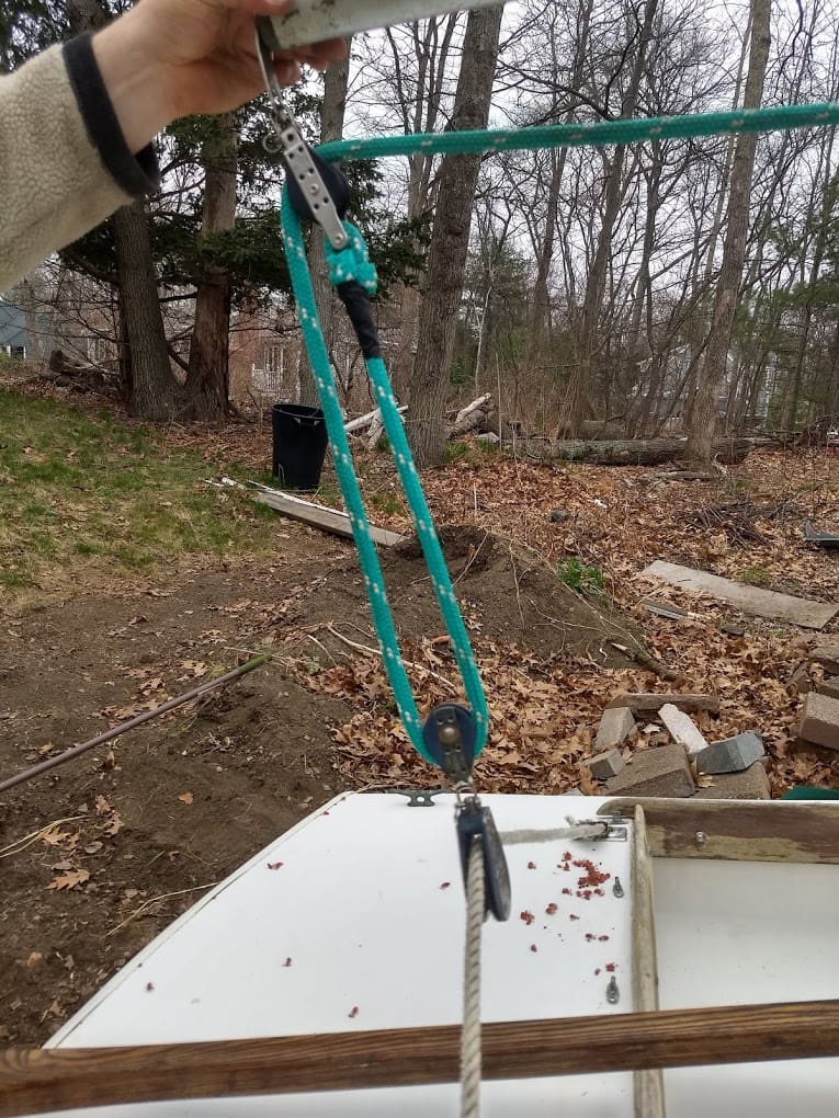

The sheets that came on my DS clone are 1/2" thick. I'm not a super experienced sailor aside from Sunfish as a kid so I'm still very much getting up to speed here. It feels to me like there is too much friction on the main sheet and jib sheet. In lighter winds, the friction on the main sheet will keep it in place even when it's not cleated. Similarly, when tacking I have to pull the jib sheet backwards through the block or it will just remain stuck.
Am I missing something?
Here's what the mainsheet looks like running through a block:

You might want to check out this post on my thread "Rope for various lines".
I believe the rope is called Dinghy Sheet, and it may or may not be available. Still listed on the Fisheries Supply site. However, there's a "PRO" version of the same thing. A bit more expensive, but either one should give you superior results. (Metric sized, you want to go fairly close to 3/8" equivalent).
Do you have a traveler in the back or does the sheet form a triangle?
1318
This is an older picture, before I upgraded the sheets. It shows how the two parts going to the traveler begin to "twist". This is caused by twist accumulated inside the line; once I had 4 wraps and couldn't release my main at all in a gust; nearly T-boned a big racing yacht because I could not turn down to pass behind as planned. Scary moment. If that happens, you can't untwist by turning the block on the traveler, you actually have to remove the internal twist in the sheet.

Thanks GreenLake! Your commitment to this forum is super admirable and appreciated. I'll check out that post.
Yes, I have a similar setup to yours with a traveler:

With that setup, you need to check that the sheet doesn't twist.
However, you can drop halyard size. I replaced the forward (middle of boom) block by a ratchet block (Ronstan 55mm) set on automatic and use ~3/8 w/o cleating the main. The ratchet block takes some of the strain so the only time you'll need full force is while trimming in.
