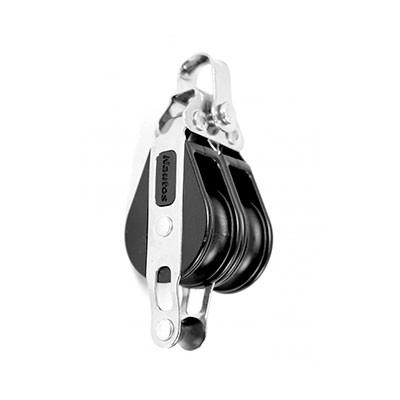

Papajoe wrote: I am not rigged for a traveler. ... The guy also has a single block on the boom that is wired to a cleat with bailing wire. So I ordered the piece to attach to the boom that holds the block from D & R. So I figured a double block would make pulling the main sheet easier. I asked about sail size because I have noticed on YouTube the videos show their masts are higher over the cockpit than mine. Mine is very low and hard to even get under when tacking. plus I need to pull it down ever farther because I am spilling to much air out of the top of the sail. The is much much faster when I grab the boom by hand and pull it lower. What are the advantages or disadvantages to the ratcheting block that you suggest? Is it more work to release the ratcheting?
If you have center-boom sheeting then definitely a double block would help. If you have a double block with a becket at the boom and a triple (or a double and separate single) at the bottom you can get a 5:1 purchase, which is equivalent to what I have. The ration requires that the final end is tied of at the becket on the block at the boom. You may find that using a set of fiddle blocks works better; I've sailed on boats that had them, but I haven't priced them compared to standard double blocks - check out Fisheries Supply: https://www.fisheriessupply.com/harken- ... wivel-2655. They have other ones, but I think 40mm is fine. If you want to use them, both ends should have fiddle blocks.
The way people fit three blocks at the bottom is to have the double (or fiddle) block go to an attachment right in front of the mainsheet swivel and have the swivel have the single block. That however requires that you have a strong point on your CB trunk (or the skills to fashion one). The advantage would be that the single block could become a ratchet block. The one I use has an "auto" setting that will release the ratchet if the pull on the line isn't very strong, that is, immediately when you let go, or in weak winds. Works like a charm.
If you only have a single attachment point you can only get a 4:1 purchase (end of the sheet tied to a becket on the bottom block). Still better than what you have.

Postby Papajoe » Mon Jun 29, 2020 5:13 pm
This is the block I ordered.
I ordered this to fix the bailing wire issue.
