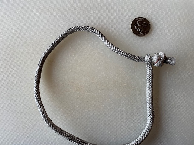

Postby RobH912 » Tue Mar 10, 2020 7:37 pm
So have I spliced some soft shackles and they have come out pretty good.
Here are some pictures of the shackle I have spliced to connect the jib sheet to the jib. I used 1/8" (3mm) AmSteel Dyneema and the pictures have the shackle wrapped with a Prusik loop around 8mm jib sheet. I think that the remaining loop will be large enough to attach to the jib clew grommet. If not, maybe just two wraps for the loop.
After wrecking some line trying to use a home made pull through picture wire, coat hanger, etc., I ended up buying a D-Splicer tool for 2-4mm line. Makes it super easy!!
Tying the diamond knot was clearly the most difficult part of this for me. Followed a lot of on line instructions / picrtures, ended up coloring up one of the lines with marker to keep track of which line was which. The knot has been very time consuming.
GL - The first shackle I spliced for practice used 1/4" line... It was good practice, but you were right shackle is giant, not sure what I'll do with it. Maybe a nautical, woven, bracelet :D
Now working on some 7/16" line shackles to attach the 30mm blocks for my traveler. These seem to be easier as they are shorter, less pull through.

Postby GreenLake » Tue Mar 10, 2020 10:41 pm
very nice. You'll get that diamond knot eventually. Sometimes, different tying directions are easier to follow than others. Have to meet you half-way, the way your own brain wants to work.
Me, if you tell me that it's a Carrick bend with each of the free end wrapped outside one of the standing ends and pushed through the middle of the knot, I could probably tie one without pictures (not speedy, but I'll get there). But that description would mean something to me the way I think about knots.
