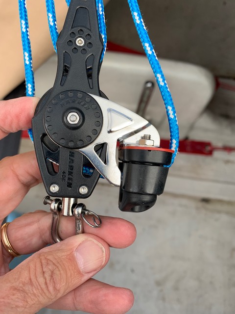

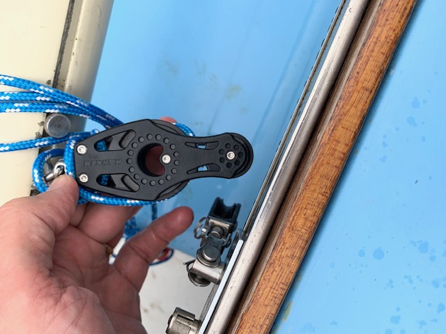

Postby RobH912 » Mon Oct 14, 2019 10:57 am
GL - yes I am not sure that the Vang set up is optimal.
There was some new hardware added to the boat recently in the process of selling the boat.
Looks like Harken 40C blocks, cleated block attaches to the mast, but has a small line, and not very much mechanical advantage.
I will do something different in the spring.
Suggestions or pictures from others on their Vangs?
Rob

Postby GreenLake » Mon Oct 14, 2019 5:59 pm
The cleat on the van needs to ope then other way, if you want to be able to release it.
I have mine strung so the cleat is in the other end (I could have also set it up so the cleat is in the middle, but as rigged, I can almost reach it from the helm position). Some people do without the cleat and lead the free end to some cleat on the CB. That's also an option. My setup isn't ideal for being operated with crew on the rail, but it works for our (often moderate) conditions. In stronger winds we simply set a tight vang and don't play it constantly.
Our vang has a cascade + 6:1 for 12:1 total purchase. Can't quickly tell where yours is at, but if it's less than that, you might want to add a 2:1 or 4:1 cascade.
So that's something you should consider

Postby RobH912 » Mon Oct 14, 2019 11:24 pm
GL - Yes I can see that the cleat would be more accessible at the boom end rather than at the mast.
I’ll need to look at it in the morning, but isn’t it simply just undoing shackles and switching it around?
It is 4:1 and have not see a cascade pulley set up before. I like that idea.
WDYT of the current size of the blocks 40, and the line which I think is 1/4 “ ? Setup seems / looks small to me.
Maybe a 55 mm set of blocks with 5/16 line... and try to increase purchase.
Rob

Postby GreenLake » Tue Oct 15, 2019 4:55 pm
I don't think mine are even 30mm.
the thing with a cascade is that the last block carries the full load (everything else is at half load).
If you have a multipart purchase, the load on each part of the line should be the same fraction of the total load. (However, because of friction, it's not 100% so).
With modern rope you can get to rather small diameters, the blue line I have on my vang isn't even 3/16" and it's plenty.
The purchase needs to be set up so that the attachment points to the blocks can handle 1/2 of the load of the vang (or 1/4 if you go for a dual cascade). For a 2:1 that's still significant but only half of what you would get if you used the purchase directly. Now, each sheave, only takes about the pull that you apply maximally at the free end - double that, if you want for dynamic loads on the vang when cleated.
In my case, it still comes to 1/12 of load on the vang (actually 1/6, because of the 180 degree turn around the sheave). Still, if each sheave can handle 150 lbs, the vang could pull at 900lbs. You simply don't need excessive diameters.
