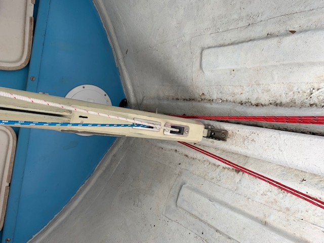

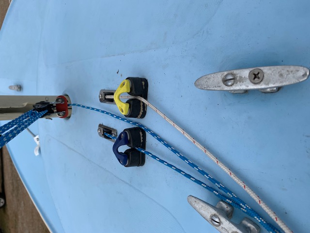

So when # 2444 hull was being restored, an older (gold anodized) Proctor mast was obtained from a wrecked DS and that mast was also restored and it replaced the original 2444' mast. Restoration consisted of sanding & painting the mast, new upper and lower main & jib halyard sheaves, new main & jib halyards, and new top of the cuddy / deck sheaves and cam cleats to secure the two halyards.
While the mast still does have a an upper sheave for a spinnaker halyard the boat was not rigged for spinnaker use.
Attached are some pictures of how main & jib halyards are rigged.
Mast is still on top of the boat on its carrier, but my inspections from a ladder don't seem to find an exit sheave / hole for the spinnaker halyard. Where would that be if I have one?
If there is not an existing dedicated exit for the spinnaker halyard, what have folks done? Trying not to drill additional holes in a mast (never a great idea).
Depending upon where the spinnaker halyard exits, I will then need to figure out how & where to cleat it.

Looking at your photos, I wish you had one showing the upper spinnaker and jib sheaves.

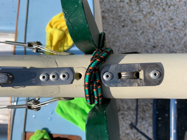

I noticed that the two sheaves at the bottom of your mast appear to not be exactly identical and have been wondering whether that signifies something. For example, are these masts factory configured for internal halyards or was it an upgrade (or option)? There seems space for a third exit sheave - there's that flat spot that extends above the other two. Perhaps all it takes is to cut a slot and add one.
As that location seems intended for the purpose, I wouldn't be as worried about the weakening effect of cutting an opening there. It's also near the end, so the loads should be different from some spot in the middle of the mast.
Unexplained are: the small slot and the gray area to the starboard side of the bottom of the mast: damage?

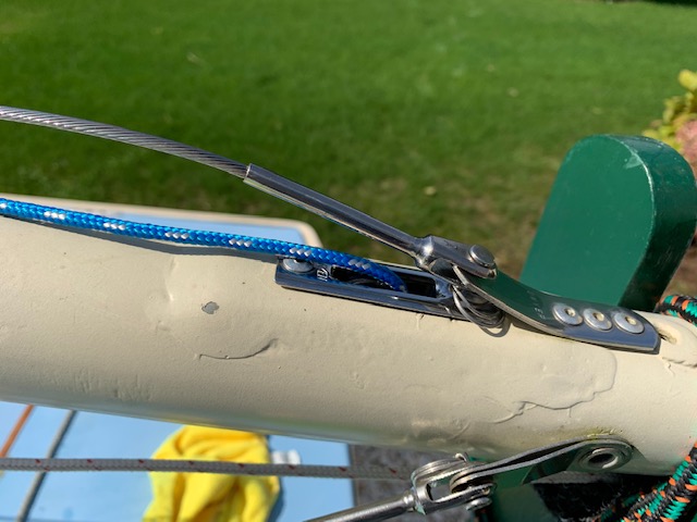

Another thing I noticed is your vang. As positioned, I can't imagine how you would be able to release it.

I've attached pictures of the upper exit points / sheaves for jib and spinnaker halyards. Looks like during the mast restoration both job and main sheaves were replaced but not the spinnaker's.

Then to be consistent, should I bring the spinnaker halyard back up and out similar to main and jib halyards are treated? Picture attached of current set up. I think it will look a little crowded up their with three cam cleats and the older horn cleats. Has anyone ever used a "power clutch device". I first saw them on a larger racing boat a couple of weeks back and it worked great. Something like this? https://www.westmarine.com/buy/spinlock ... a--1881077. I'd look to see if there is any better pricing. Looks clean and would be very functional.
