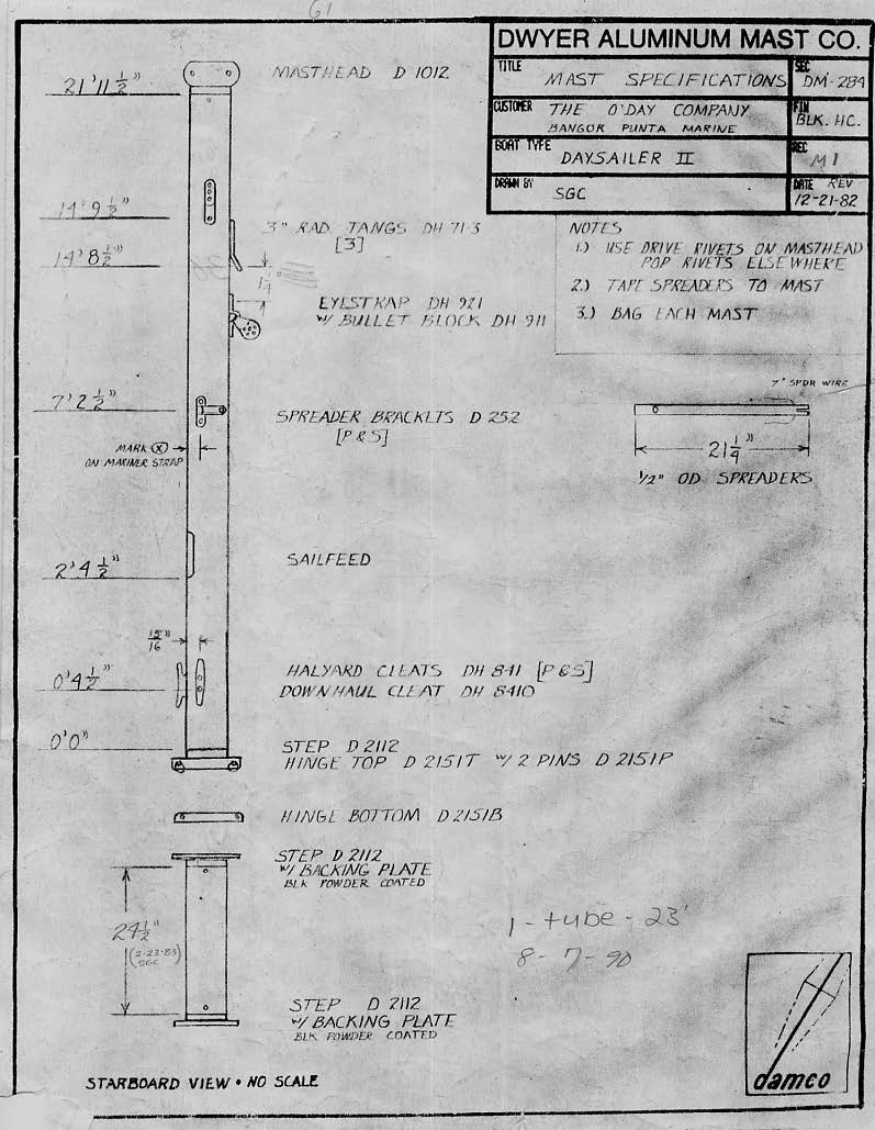

I've attached the spec sheet I received from Mike at Dwyer
It looks exactly as mine (1984 DS2), but I'm going to verify dimensions.
I also need to determine the offset for the spreader brackets to get the correct sweep for the shrouds/side stays
One step closer
