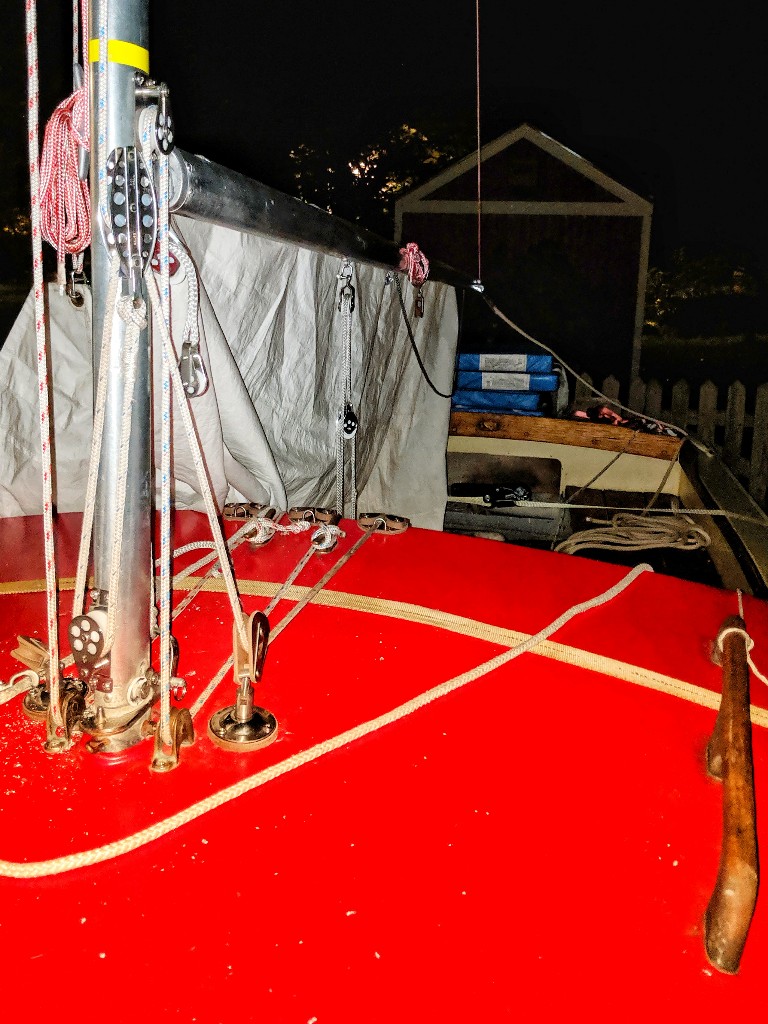

Too hot and windless to sail. Did some overdue rigging work today - my new jib tensioner:
Jib tensioner
Please excuse the night shot, I waited till sundown to work. And don't mind the mess! Unrigged lines all over the place.
Anyway, this is the front of the mast and the port side of the cuddy roof, looking aft. The blue-flecked line is the halyard, and goes in a zig-zag. Down the mast, into a spare fiddle block on its largest sheave, over a cheek block (near my yellow Band 1 marker), down to a bronze foot block and back to a horn cleat. The tensioner/fine tune is the grey-flecked line, it starts at the becket on the fiddle block, goes to a cheek block at the base of the mast, back to the fiddle block, down to a deck block and back to a cam cleat. The fiddle block moves, the two cheek blocks are stationary. The exact angles and position of the blocks were tested out to avoid rubbing or jamming. As it's an external halyard, I also had to watch out to leave some clearance by the spinnaker pole ring. Tight quarters! But I got what I wanted - all jib controls to port, mains'l controls to star, vang down the middle.
Testing on land went great, a good tug on the tensioner leaves the halyard bowstring tight, it twangs! Probably more than I want to tighten it in practice, but good to know that I have the ability.

Hi Tom, I have a question for you, What prevents the fiddle block from jamming up or not staying in position when there is no tension on the halyard, when you drop you jib? Will the fiddle block go back into position when you hoist the jib? Or do you have to hold the fiddle block by hand to get it in the right position while you hoist the jib? I can see your system working if the fiddle block rides up and down on a track. This would prevent it from flopping over and jamming the halyard or tensioner. Please let us know how your test sail went. Thanks, John

I'll post a picture of mine when I get a chance. It looks like a toy compared to yours :)
You have 3:1 in the rigging of the tensioner and a 2:1 cascade the way you pull on the jib sheet. That's 6:1. You should be able to get some serious tension with that one. Mine's a simple 2:1 using 2mm line :shock:

Good question, I'm also wondering how this rig will behave when on the water, not to mention when I unstep the mast for trailering. That being said, I usually don't have lots of slack in the jib halyard, even with the jib down, because I use a downhaul. And the fiddle block is right up against the mast, so there's really not a lot of room for it to get flipped around. The total "travel" - halyard slack to tensioner all the way tightened - is only a tad over 4 inches. All this work for 4 inches! :)
Nevertheless, I went and tested slacking off the halyard enough to tangle the fiddle block. I had to slack it off till the block hit the cuddy top before it flopped over, so I think we're good here. If not, I was already thinking of rigging an eyebolt right beneath the yellow band and a small length of bungee to hold the block up. We'll see after a few sails.

Yes, I probably overbuilt. I was going to use a single plain block shackled to a single becket block for the "moving part," but then I got my paws on that fiddle block (leftover from another project) and figured that I could use it "upside down and backwards," so to speak. The cheek blocks are Shaefer 3-series, one curved, one flat. Both were ebay finds, so considerably cheaper than retail. The rest - deck blocks, cleats, foot block - were either original to the boat or parts I bought during a super-sale from CLCboats.com (great site for dreaming!).
Note, my original plan was to use smaller stuff from Racelite - I love them but am always confused/dubious about what working loads their blocks can handle. I guesstimate a SWL of 600lbs on their blocks. So quick calculations, it's a 3-1 pulley, I can easily put a 200 pound pull on it when really tightening down, throw in the mast forces when bouncing over waves... starting to get risky. So overbuilt it is. The cheek blocks cost me $30 each with shipping, the fiddle block I'll call "free" and the rest is sunk costs. So $60 to tighten my jib halyard by 4 inches, don't tell my wife! :roll:
