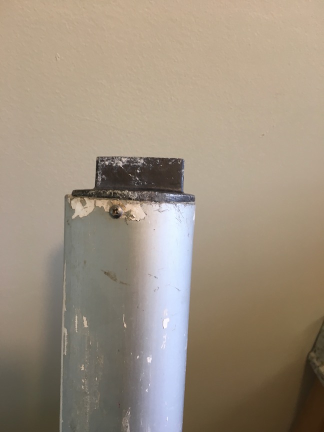

The question I have is the lower section of the mast is not connected at all to the boat, so I was told by the previous owner that even with the tabernacle it will take two people to step the mast because as you are raising the top of the mast, the bottom also lifts off / out of place. Seems to defeat the purpose of having a tabernacle.
Rather than having an open bottom on the mast to fit on top a mast step casing, the bottom of the mast has a tenon shape sticking out made of hard plastic which fits into a "metal tray" where the mast rests.
The metal tray has side holes and there are pins / bolts going through the tray which prevent the foot of the mast to move back or forward.
To secure the bottom of the mast to the tray can I simply drill an appropriate sized hole through the mast tenon, step the bottom of the mast and secure with a clevis pin / cotter pin set up?

Drill through here?

Postby GreenLake » Thu May 23, 2019 3:45 pm
Make a plywood disk with a hole that fits the mast profile exactly, and attach it to the lower mast portion with a hose clamp (so it rests against the deck - the hose clamp would be wide enough to not slip through the hole). That should prevent the lower portion from rising while the mast is stepped.
Alternatively, similar disk, but drill a hole in the mast support just below the deck to insert a pin that keeps the disk resting under the deck. Same effect. Just make sure that you size the pin to be strong enough to hold your weight in shear (because if you step on the deck, your weight would rest on it).
Does that help?

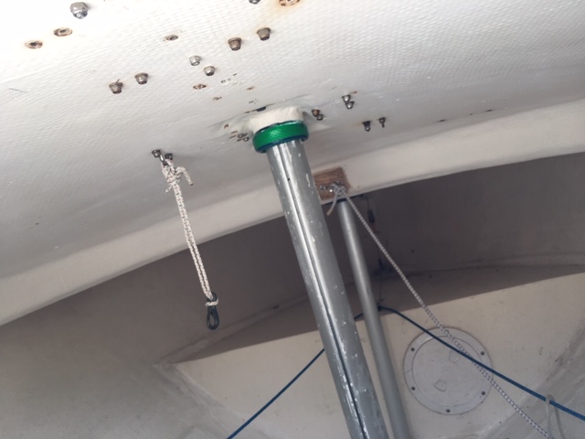

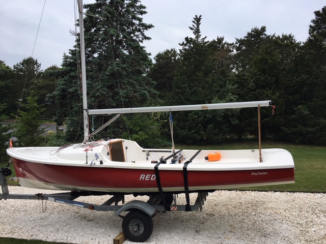

Postby RobH912 » Sun Jun 16, 2019 11:05 pm
Holding the Mast butt in place using a “collar” made from a piece of garden hose and a hose clamp worked great.
Stepped the mast today in the driveway for the first time. The mast butt did not lift at all as I walked the mast up.
The hardest part of this solution was getting into the cuddy cabin to tighten the clamp.

Here are a couple of pictures

Postby GreenLake » Tue Jun 18, 2019 3:18 am
Looks great!

Postby Signalcharlie » Fri Jun 21, 2019 6:23 pm
Just found the thread, nice work. Our lower mast section is secured just below the cuddy top, like you did. Your question motivated us to finally replace the old hose clamp, it was not marine grade stainless and rusted, came apart one day while lowering mast. The new clamp is marine grade stainless, and it tightens around a rubber spacer to prevent dissimilar metal corrosion.
So our tip is to make sure to use a high quality stainless clamp.
