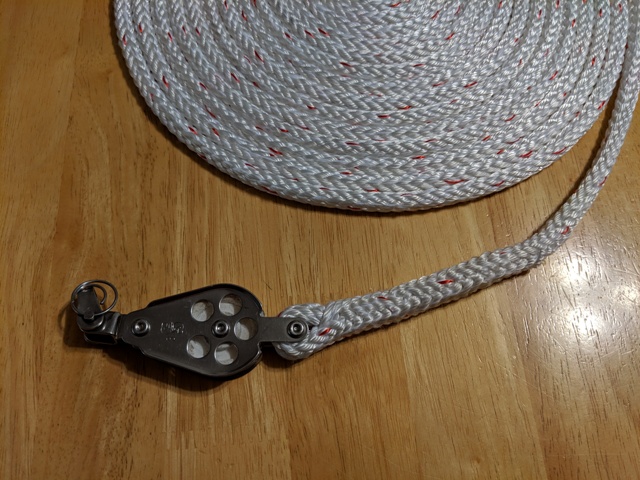

Postby Woreign » Tue Apr 23, 2019 7:55 pm
First time splicing! Here's my new main sheet and block!

Postby GreenLake » Tue Apr 23, 2019 8:50 pm
Nice.
