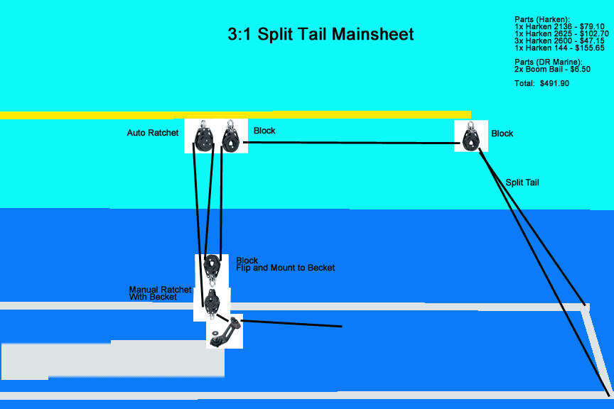

I previously mentioned rigging a split tail mainsheet up on the boat. Without getting into crosby vs mid-boom vs split tail vs RYO hybrids, etc... I created a couple of drawings (with parts and pricing) to see what kind of feedback I would get. I know little about this design, but from research I have found a couple of ways I could come up with to do it, each getting more and more complex/expensive. I am curious to the benefits to each, and/or point of diminishing returns, particularly on the the Daysailer. Please excuse my Photoshop skills, as these were quick sketches. Hopefully they are easy to follow.
Design 1 - Mike Gillums Split Tail (Golden Standard?)
I am assuming that the purchase here is 1:1, and Mike uses a double ratchet system. One auto-ratchet on the boom, and one manual ratchet on the swivel base that can be turned on or off depending on wind/conditions. I currently have a 3:1 (roughly 25ft of line in the purchase). Mike's design seems to cut down on line at the cost of needing more muscle in the wind, at least to sheet in, and maybe sheeting out can have a loss of precision at times (I think this is what the double ratchets solve)?
Last edited by DigitalMechanic on Sun Oct 01, 2017 3:08 pm, edited 3 times in total.

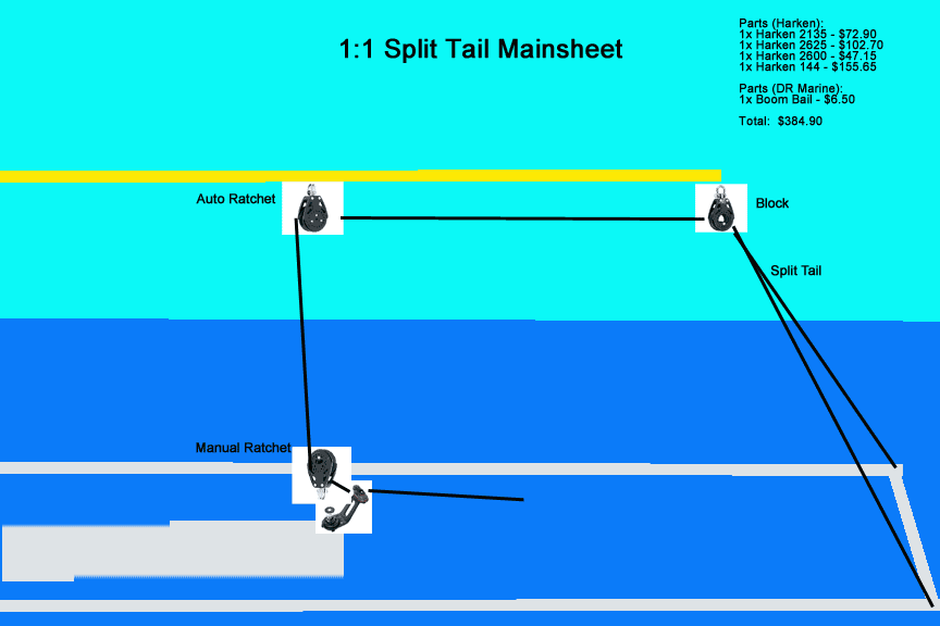

Postby DigitalMechanic » Sun Oct 01, 2017 11:40 am
Design 2: Adding Purchase
Here I think that I have added a way to bring it back to 3:1 or there about. At any rate there is definitely more sheet added, thus more purchase added. Again, keeping the auto ratchet on the boom and manual ratchet on the base. However, would a double ratchet system be beyond the point of diminishing returns with this much purchase? Mike seems to think that double ratchet system is valuable, and I believe that it may be, but only on heavy conditions. I know that my current 3:1 w/ just an auto ratchet seems to be fine to me most of the time. However, the days when we get heavy wind, holding the sheet in hand for long periods can get tiring. I think I can see the value, but ratchets are so expensive...

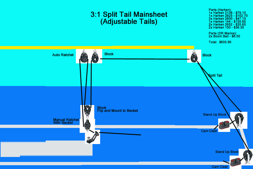

Postby DigitalMechanic » Sun Oct 01, 2017 11:47 am
Design 3: Purchase Plus Adjustable Tails
I have seen this on other boats (IE Albacore, Snipe) something called an "Augie Equalizer" used. It is hard for me to follow in pictures and understand, but what it appears to be is an adjustable tail setup. My sketch may be way off. But keeping it simple, I just added stand up blocks and cleats to the aft end of the gunwales. For racing however, I imagine that these would need to be rigged so they could be grabbed from a hiking position, thus massively complicating rigging (drilling holes in the boat to get things back to center, etc). Anyway, without getting the rigging perfected, I am curious what value an adjustable tail may provide on a boat like ours? Again... point of diminishing returns? Just curious about the value of adjustability here? Apparently the other guys think it is of value?

Postby GreenLake » Mon Oct 02, 2017 1:19 am
Very nice summary.
I have a modified combination of the first and last scenario on a 15ft dinghy. A single ratchet (manual) at the bottom and instead of the tails being individually adjustable they are tied together and then that knot can be pulled on for some added tension.
That's a setup that I'm unfortunately not able to evaluate for you because I have not mastered that boat to where I can truly sail it to its capabilities. (I simply prefer the DS and that means I'm not spending enough time on the other boat).
On my DS I have more purchase than your scenario 1 - if I wanted to get the same purchase but using split tails I would need to take your Design 1 and add a 2:1 cascade. While that's not practical (you don't want a floating block hanging under the boom and the range would be limited to the length of the cascade (about 5', which is not enough to let the boom come forward) it tells me that my overall purchase is better by a factor of two than your Design 1.
To me, that amount of purchase feels about right (and my sailing conditions tend to be a tad more on the moderate side, but it handles well on the occasional days where I play it by hand in 20+ gusts. Incidentally, I make do with a single ratchet block, but one that that's rated as exceeding the competition's holding power by about a factor or two in some independent test by a technical sailing magazine. I also rely exclusively on the auto setting and never had any reason to change that - it simply knows when to disengage.
I've made some changes in my traveler setup and can't tell that they seem to have brought "big" changes - I lack the like-for-like comparison with another DaySailer. Barber inhauls were another matter. Their effects were directly observable.
I'm as curious as you to hear what any other, more expert DS sailors have as comments on your Designs.

Postby GreenLake » Mon Oct 02, 2017 4:21 pm
With both sails you have sheeting angle and leech tension.
With the jib, the inhauls directly affect sheeting angle, while the ratio between leech and foot tension is determined by the position of the fairlead on the track.
With a traveler on a track across the cockpit, you could set the leech tension on the main using the sheet, and then adjust the sheeting angle by moving the traveler car.
With a strong vang, you can let the vang take care of the leech tension, letting the sheet control more of the sheeting angle. Particularly as you let out the main, the boom would not rise and thus keep the sail flat. However, you can't effectively pull the boom in once its close to centerline, as the sheet will point down. A split mainsheet and the various triangle configurations that simulate a traveler at the end of the boom will preserve some horizontal pull as the fixed point that the sheet is acting on is the outer block on the transom and no longer the CB trunk fitting.
Incidentally, as you add more purchase between midboom and centerboard, you are degrading the effect of the split tail. The way to think about it: the force in a rope through a purchase is constant, the pull on a block with 180 degree turn is double that force (once for each part going to that block in parallel) -- similar geometrical reasoning gives you the force on a 90 degree block (total force on the block is 140% but force component in the direction of the pull is single).
Now, at the end of the boom, where one end of the split tails takes the load, you get a single part pulling at the end of the boom at 45 degrees to the side and down. Meaning your side force is 70% of the force you expend pulling on the rope. If you add more purchase (design 2) all you do is reduce the force at which you pull. You still get 70% of that force pulling sideways at the end of the boom, but now that's been reduced by the same factor.
More parts go between mid boom and centerboard (up and down at close hauled) and you add all those forces to your leech tension instead of sheeting control.
With a boom vang, you can supply leech tension, and perhaps as a result you'll need a bit less force on the main sheet to bring it in, allowing you to go with Design 1.
As you write, all the pieces work together.
Another element of the system is the centerboard. In order for it to work, the boat has to sail with a certain degree of leeway (difference between course and heading in the absence of current). That leeway provides the CB with an angle of attack.
The DS CB is said to be a bit underdimensioned (and the factory ones have no profile whatsoever). I could imagine that this means there's a limit to how aggressively you can sheet in, compared to other boats. If you haven't already, I would definitely look into getting (or making) a properly foiled CB and rudder.
Some finer points of the trim (and rigging layout) you won't be able to tune without having a like boat for comparison. The effects are real but too small to eyeball or measure with a GPS (as the wind isn't constant, for one).
That said, I claim I noticed a definite effect from the inhauls (if only to make the jib "set" better in certain conditions). I have also noticed some improvement from a partial re-foiling of the CB (most noticeably I was able to eliminate CB hum). I wonder if a fully foiled replacement board would make a difference. Perhaps if I get bored, I'll build one. I did a pretty decent new rudder. It reduced weight at then end of the boat and feels better, but I can't tell whether it would make a difference in boat to boat comparison.
Adding a vang is too recent for me to be conclusive about it, and I'm not sure I know what I'm doing with it yet, but in some conditions I acquit myself quite well in our mixed fleet (where most of the boats have faster ratings).
So, definitely good thinking all of that through; don't know which of these changes is going to be that muffler - i.e. something that pays off once you make other changes.
