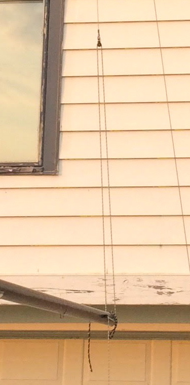

Besides this change in mast points, I also fabricated a topping lift, based on the StingySailor.com article. I made the lifeline with swaged eyes myself, but its a bit short. Not a problem, but the line I used to rig it to the boom is also to short, so I am again going to have to buy more line.

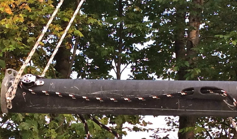

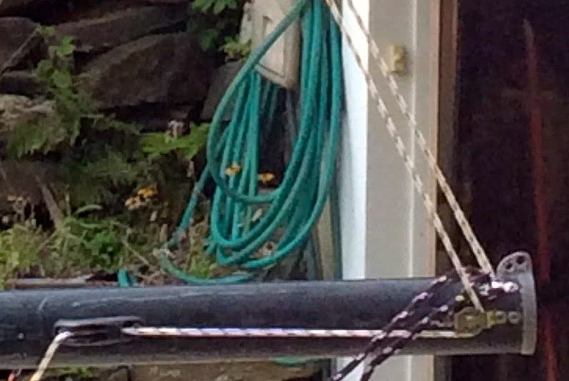

Sorry for the bad picks. I used my crappy iPad. Here is the new outhaul tackle and the topping lift tackle. I am very pleased with both. Eye splice on 3/16" line was hard....
