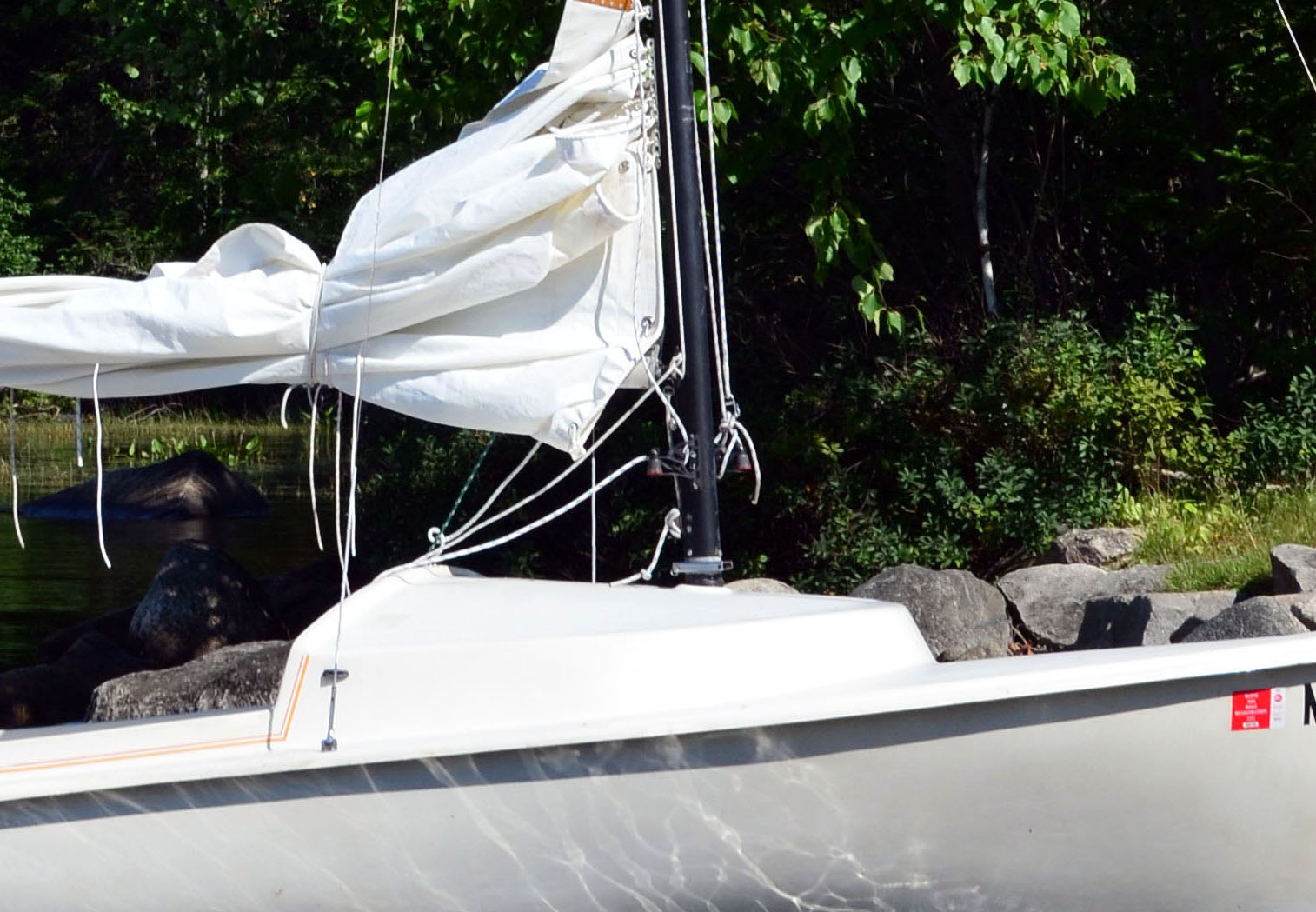

The cleats are at the base of my mast, and I've never had a halyard pop free. I have had them catch a halyard while lowering the sail. What I also like about them is that I can grab a halyard and tension the luff enough to take some belly out of the sail as the wind picks up.
You can see where they're located in the photo attached.

Postby fatjackdurham » Tue Aug 08, 2017 9:30 am
Is the one on the front of the mast the jib halyard or the spinnaker. If its the jib, why is it on the front not the side?
What is the other line that goes to the small cleat near the boom? Topping lift?
Did you have slugs added afterwards or buy the sail that way? I just bought a new mainsail, but I think it's a bolt rope only. I kind of would like to have slugs to make it easier...

Postby geofisherman » Tue Aug 08, 2017 8:49 pm
The cleat showing in front of the mast is the jib halyard. It is mounted on the side of the mast and can swivel from back to front. I use the jib halyard to hold the mast up while pinning the forestay, so it was still facing towards the front of the boat after rigging. The jib was not rigged when I took that photo. While sailing it would face towards the back like the other cleat (main halyard).
The other line is indeed my topping lift.
