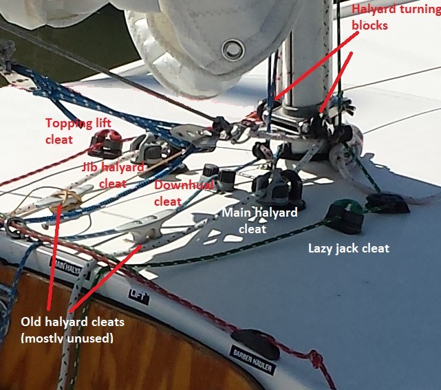

Since I got this boat, I've had trouble getting the main to rise all the way to the top, unless I'm in absolutely no wind and even then the halyard wants to slip some. Do you guys use the cleats on the side of the mast and are your halyards double braid line? My old boats halyards were just twisted rope and all I had to do to cleat them is just spin then around the cleat into themselves. Even using proper cleating, I find these will slip some.
My second question(s) have to do with the cleats and eye strap. What are they for?
I've contemplated removing the main halyards cleat and putting a pulley in it's place and using the cleats on the cabin roof. It seems like it would give me some mechanical advanage.

Cleats 1 & 2 are the main halyard and jib halyard cleats, respectively, on my boat
The halyards come down the mast, through cheek blocks on the port (main) and starboard (jib) side of the mast and then I cleat them off,
after hoisting, off your cleats nos. 1 & 2.
If your traveler is the crosby type like I have on my boat, sometimes the boom gets under the traveler and then the main won't hoist all the way up.
Slippage on the halyard is not something you should have if your halyards are cleated off right, you could have some stretch if you have nylon halyards,
for some reason, but never slippage. The small cleats on the mast may not let you adequately cleat the thicker diameter halyards, From the vang setup you have, I'd say the PO had things figured out and you just need to make sure you're doing it the way he had it set up.

Hmmm. Just now spotted the cheek block on the starboard side of the boom. What's that for?

And two more thoughts:
The boom seems to have stopped at the upper end of the sail entrance slot. Any chance the boom is stuck there? It should be able to rise up into the sail slot. Or maybe it's there because the main isn't hoisted.
I'm not spotting a downhaul line on the boom. Maybe it's hiding among the other lines in the photo? If it is, maybe that explains the padeye - it's an attachment point for the boom downhaul line.

Alan wrote:Hmmm. Just now spotted the cheek block on the starboard side of the boom. What's that for?
Alan, the cheek block is something I just added for a jiffy reef system. I have one on the back as well. The previous owner had added 3 cleats at the back of the boom, so I took the V grooved cleat that was suppose to be for the back haul and reversed it to use for the forward jiffy reef to cleat off.
The down haul is buried in between the cleats on the mast, I added a little cleat that is secured in the masts slot (something like my Oday 22 had). Previously I used the eye strap, but it didn't seem right, so the cleat was just laying round and I took a couple of 1/4" screws and nuts and slid it down the slot.
The vang was added by me, the previous owner used it the day we took the boat out because he couldn't find the main sheet. So after we got back and he found the correct one, he just told me to keep that one. It's a main sheet for a much bigger boat, but I figured it would work as a vang.
The booms goose neck does stick sometimes but in the pictures the main is not up, so it's just sitting where it is. That little down haul cleat lets it rest there but also lets me have the down haul preset, so I know when the main is fully hoisted.....or in most cases not.

3 & 4 might be part of the vang setup? In the picture the vang does not look to be attached in a proper location. Typically the boom vang attaches to the mast via a rope tied around the mast, where pressure is put on the front of the mast creating a "pull though" vs "pull away from" effect on the mast. The rope is held low on the mast by using a padeye on the front of the mast near where it meets the cuddy roof. One of these things... http://www.starmarinedepot.com/sea-dog-pad-eye-stainless-3%2F8%22.html?gclid=Cj0KEQjwte27BRCM6vjIidHvnKQBEiQAC4MzrU7amTVXfW48tXmGoflsoixttgz7Is-sbVZwxZub3OkaArl68P8HAQ
#4 might be where the previous owner was attaching the vang, and #3 may be where he/she was cleating it off. If that is the case, I hope there is a large metal plate underneath the cuddy roof.
Might have been trying to do something like this...
2184
At any rate if I am correct, that setup is not safe and you may end up tearing a hole in the cuddy roof. I think that the cleat location is fine because the pull on that is sideways across the cuddy roof, but the pull from the padeye straight up on the cuddy roof looks dangerous. If you look at the picture from my album above you should be able to see what I am talking about, as how to do the wrap around the mast with rope and attach the vang.

I have my vang connected to the boom with a bale and to the mast's tabernacle rear pin with a bale (I saw a picture and it looked like it would save me from drilling more holes). If this is wrong, point me in the right direction. I've never had or used one. I also included a picture just looking down the boom, in case you see anything wrong. The 2 cheek blocks I added for a jiffy reef (also new for me), on the opposite side are pad eyes. I just use the existing cleats to secure the reef.

So, you added the bale? I would not say that it is wrong. You cannot see in the picture I have but on that lower part of the front of the mast below the tabernacle near where it meets the cuddy roof, there is a padeye that keeps the blue line wrapped around the mast that the vang attaches to, held low. My vang cleats off of the cuddy roof, so keeping the connecting point as low as possible is necessary. With your vang setup the bales look like they will work fine. You will get a little more of a 45 degree angle by sliding it down a little more, but you are correct, you will have to drill a couple holes for the padeye.
If you do change it, put the padeye in the front of the mast and wrap line around it to tie/attach the vang to. If you add a stronger vang later, and the you have put the padeye in the back of the mast and connected the vang directly to it, I believe that is is possible that the tension from the vang can pull it out.

It looks like your boat has a hybrid system. I wonder if the mast is original? Anyway, the two cleats on the sides of the mast are not supposed to be there if you have cleats on the cuddy top. Those cleats are supposed to be cheek blocks that feed the halyards back to the cuddy cleats. Older DaySailers just had those two cleats on the mast and no cuddy cleats (the reason I wonder if your mast is original).
The cam cleat on the cuddy top is for the boom downhaul. From the eyestrap arrangements, it looks like the previous owner had it set up for a line to originate at the lower eyestrap, go up to a block on the gooseneck, back down through a block at the cuddy top, and aft to the cam cleat. See photo below.
Note that I got all cleats and blocks off of the mast. That was to minimize the chances of hooking the jib sheets on the hardware when coming about. Some things that might help with the final lift on the main--
* Make sure the vang, downhaul, and sheet are slack.
* Haul as high as you can, belay around the cleat, and then pull out on the line, away from the mast. (You have tremendous mechanical advantage.) If that lifts the sail, quickly pull in and cleat the line before the sail drops back down.
* Use the lowest-stretch line you can afford. North American Sta-Set X is probably the cheapest. It uses conventional polyester fiber, but there is very little twist in the core. For more money, you can go with more exotic fibers like Dyneema or Spectra.
* If you can get the sail high enough that you have 3-4" of space in the sail track below the gooseneck, don't worry about it. You're there. Just use the downhaul to tension the luff as needed.
