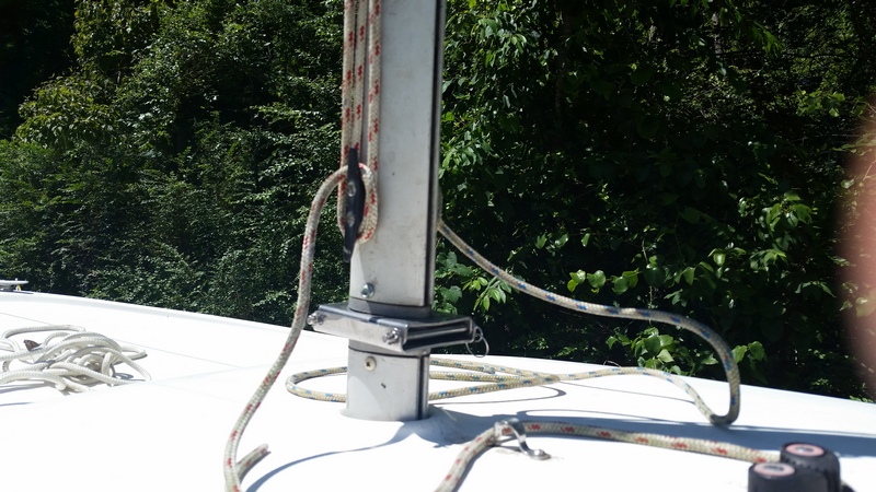

Just to work with what I have, I posted several pictures of my hardware for rigging. Not real sure what the "Mast Deck Hardware is for.
Mast Deck Hardware, not sure what it was thought to use for
Mast Hardware.jpg (136.82 KiB) Viewed 20253 times

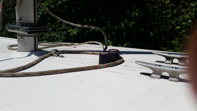

Mast Cleats
Mast cleats.jpg (203.03 KiB) Viewed 20253 times

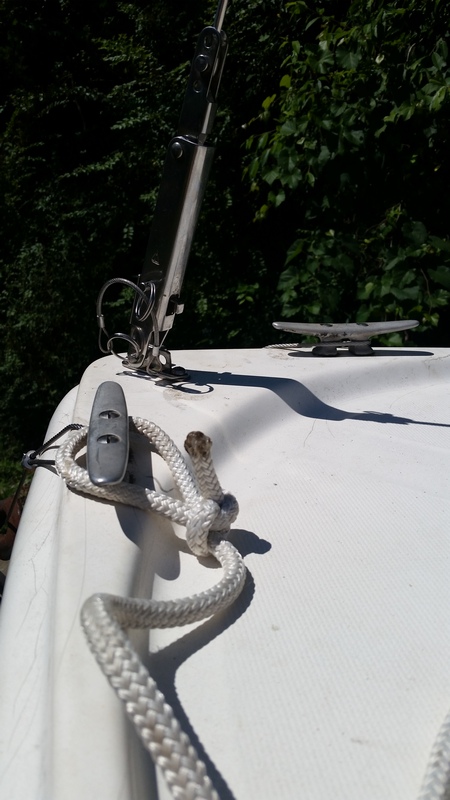

Foredeck showing forestay sail hook and cleats

jsbowman6 wrote: how do you keep the jibs tack connected to the forestays hook?
The second (aft) hole is where I shackle my jib tack to right behind where your forestay QR lever is attached in your photo. This is also very close to where my swivel turning block is located for the jib downhaul line.

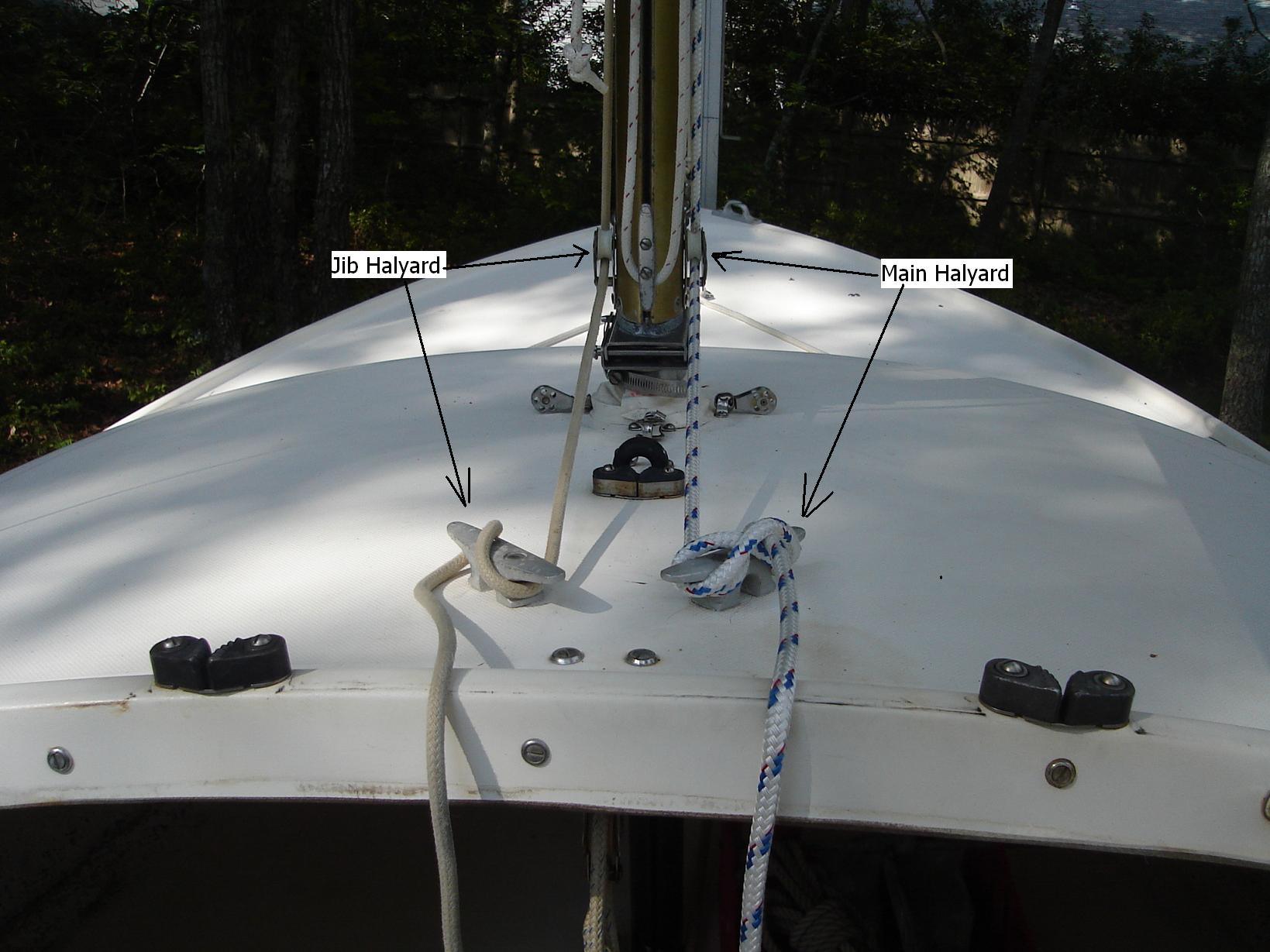

The DS I and early DS II had the halyards lead back to the cockpit ,but I* find I can tend my halyards standing in the cockpit, although I usually raise the last 6" or so of the main while standing just forward of the mast. I then raise the jib usually from that same position. I am on a mooring, so the boat is pointing close to directly into the wind, that helps. You definitely want the boat as close to pointing into the wind as you can for raising/lowering sails. I see that your boat already has the cleats for running the halyards back, maybe your mast has been replaced and the turning blocks removed? I suspect camcleat there is for boom-vang? I added a picture of a DS II showing the halyards run aft from the mast. Other than the halyard cleats and what I again assume is a cam-cleat for the boom-vang, the other cleats are unknown as to usage
This boat has more hardware than yours!
, suspect the 2 cam cleats on the aft edge of the cuddy are for the spinnaker halyard and maybe topping lift for pole?

3rd how do you keep the jibs tack connected to the forestays hook?
I don't have a hook, my boat originally had a shackle on the jib clew that attached to the stem fitting, I changed that by removing the captive shackle and instead adding a swivel-snap shackle to the stem fitting that clips to the eye at the jib tack. I don't see what you mean by "the forestays hook". You have the same stem fitting that I have. However, I don't have that lever to tension the forestay, I wonder if it needs to be turned around to give more room to attach jib tack to the stem fitting?

Thank you, Sunbird, for your replies and photo! Gave me lots of great ideas for rigging my halyards; my wife and I recently inherited my dad's trusty DS (I actually don't know if it's a DS1, 2, or 3), and I've been mulling over how to make it more comfortably sailable by myself without having to run to the bow and pray every time I want to raise and lower the jib and main. Great to see visuals of modifications to the main/jib halyards!
