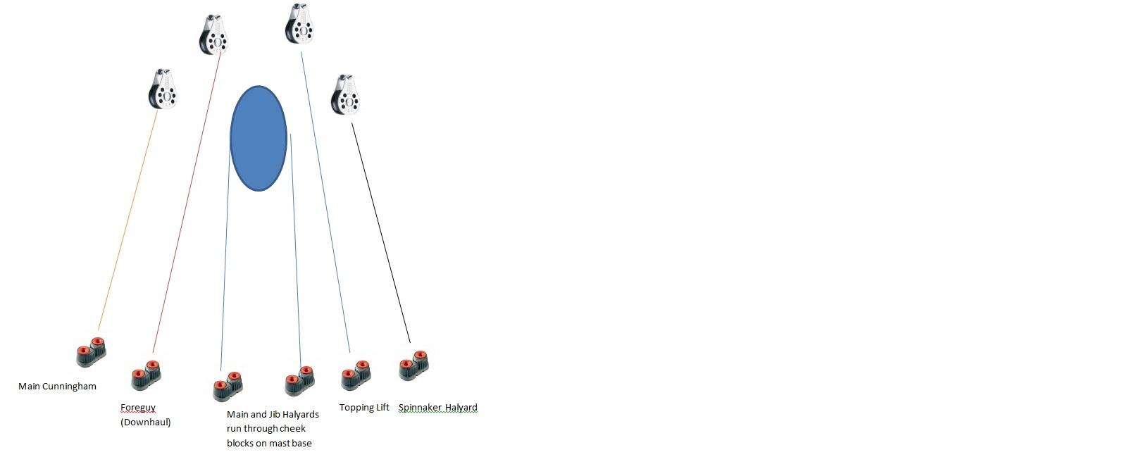

I use Harken micro blocks attached to the deck with an eye strap at the base of the mast. These blocks turn the halyard, topping lift, and foreguy lines towards the cuddy top where they can all be cleated.
I haven't had any problems with this set up and it was the cheapest option (found some "used" ones that looked new). I haven't had much need for the foreguy, but I like knowing it is there if I need it.
Also, all of the lines that pull things "up" are on the right and "down" lines are on the left.
I have also installed these clam cleats just aft of my shrouds to cleat the sheet/guy from the forward crew position. They help a lot with control and work great.
https://www.westcoastsailing.net/defaul ... 91064.html
It may be more complicated than it needs to be, but it has worked great for me. I raced all last summer with this set up and as long as I kept the sail from tangling, I was golden.

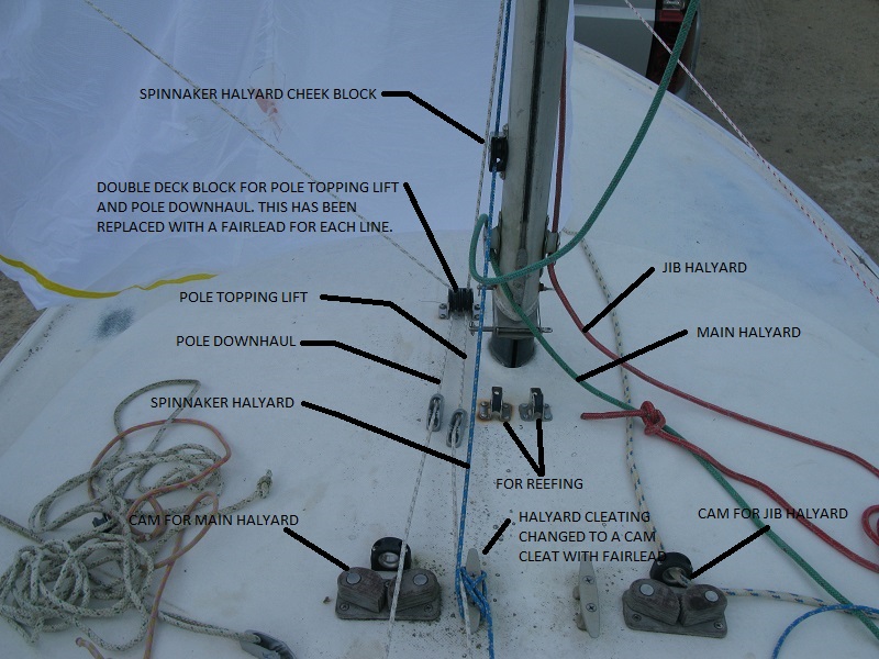

Postby jeadstx » Sat Dec 24, 2016 4:50 am
The picture shown earlier in this post of my cuddy cabin roof shows two deck blocks. These were part of my reefing system. My reefing system has since been updated. Attached is a picture of the cuddy cabin top of my DS II with labels showing hardware, although this was updated and modified after the first race I sailed with a spinnaker in October to get ready for the Wurstfest Regatta in November. The modifications were an improvement.
In the picture I have a double deck block for handling the pole topping lift and the pole down haul lines. The block was causing problems and not as flexible as I wanted, it was replaced with a fair lead, one for each line. Originally I cleated the spinnaker halyard to the horn cleat, but added a dedicated cam cleat with fair lead forward of the horn cleat. Much easier to use for me.
I am currently setting up my DS I with a setup similar to the DS II. The one thing I'm changing is the clam cleats for the pole topping lift and downhaul lines. The ones used on the DS II have the built in fairlead. We found that when releasing the lines the fairleads tend to cause the line to slip back into the clam cleat. On the DS I, clam cleats will also be used with a separate fair lead to provide more spacing to allow better line release. This modification will be done to the DS II as well.

Nice picture.
I don't bother with a separate control for pole topping lift, using a fixed rope with a section of doubled 1/4" bungee cord. As a result, there's a constant pull on the pole, strong enough to more than counteract the weight of the pole, sheet and sail. With that, I only need to adjust a single line (downhaul) to set the height of the pole. (Any force from the sail, other than weight, is likely to attempt to lift the pole).
I also tie topping lift and downhaul together to a single shackle, so I can attach both in one motion (to a single fitting on the middle of the pole). When not in use, the shackle is clipped to the mast ring (under just a bit of tension), and I snug down the downhaul as well.
I don't use fairleads for the cleats, but place them on the aft-facing lip of the cuddy opening, so that the 90 degree bend assists in cleating the lines (halyard and downhaul) but unlike a ring on the cleat, it won't "re-capture" them when I throw them off.
