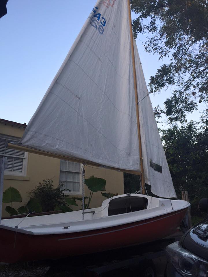

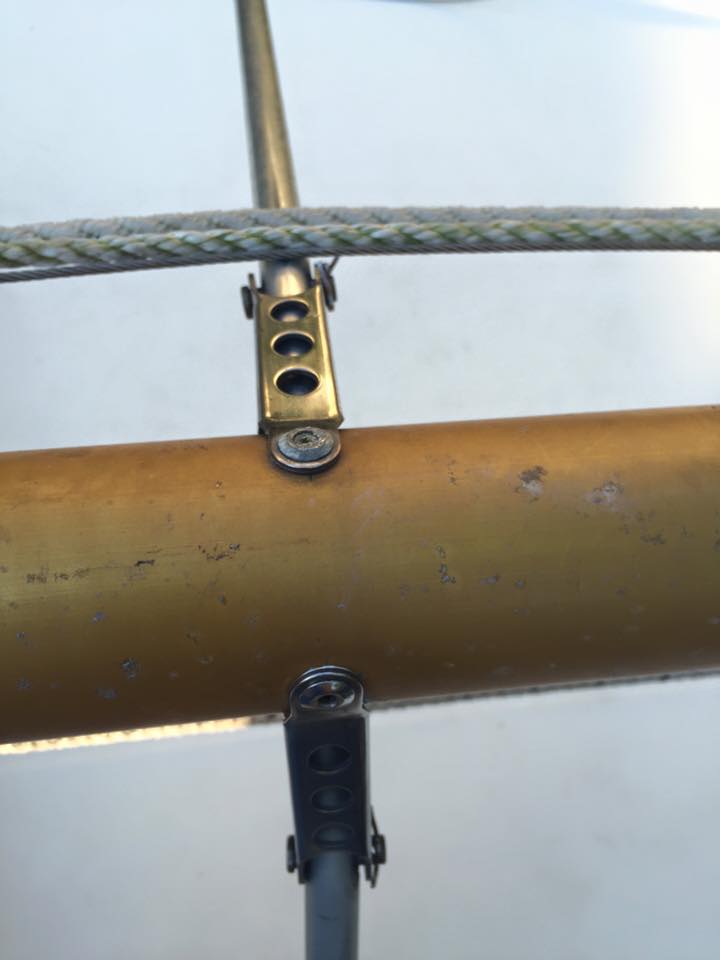

Postby DigitalMechanic » Wed May 25, 2016 9:08 pm
The spreaders should float horizontally in the swivel bracket attached to the mast. Thus the side stays will auto-magically position the spreaders in the arc around the mast that they should be. On a broad reach, the sail is going to hit the stays (which are attached to the spreaders). I often seem to be hitting the spreaders with the sail on a lesser beam reach, with the tell tails flying back like they should, and I have brand new crisp sails.

Re: Spreader bracket positioning
Postby DigitalMechanic » Wed May 25, 2016 9:15 pm
Actually my speaker brackets are not perfectly symmetrical. I can see that one of the spreaders looks a little more cocked forward than the other (starboard side), but that is because the bracket is slightly placed a little more aft on the mast (maybe millimeters). Again at the end of the day, the angle the spreaders sit at is not determined by the bracket but the side stays, so the angles are auto corrected.

Postby Shagbark » Wed May 25, 2016 9:29 pm
Digitalmechanic,
Thanks for the pics. That second one really tells the story. The front edge of my port side bracket was aligned on the center line of the mast. I wasn't really sure if my starboard side bracket should move forward so that it touched the port side bracket; or if the port side bracket should be moved aft. I slid the port side aft and now it looks similar to yours. I will need to raise my mast and check for the 'auto correction' that you mentioned.
