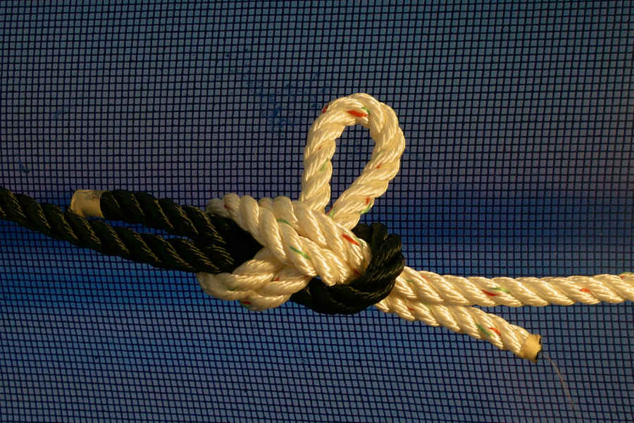

Here's my variant of a sheet bend with extra loop.
Sheet bend with extra loop
