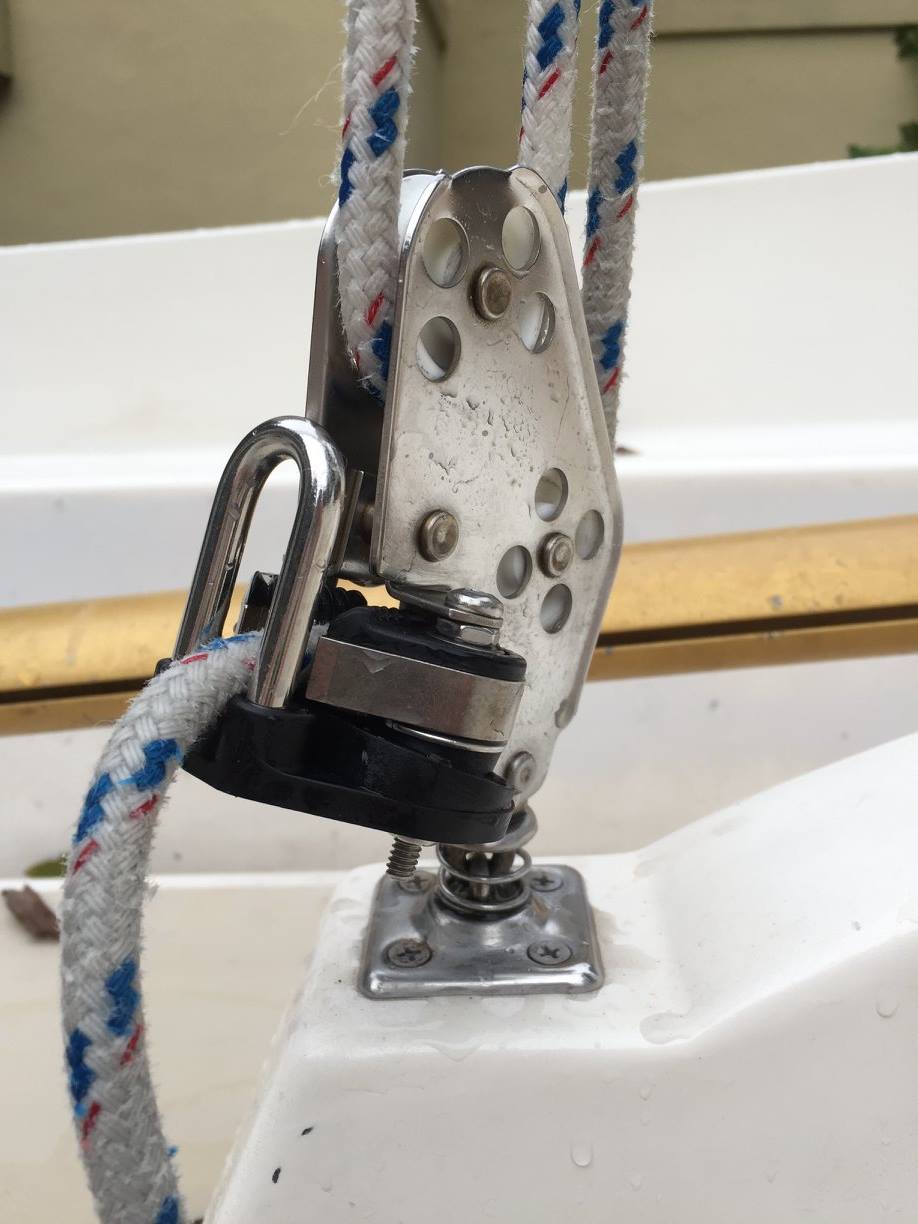

On my boat the cleat is on an arm mounted under the fiddle-block (double-block on CB trunk), the cam-cleat is mounted on the top of that arm and the sheet is cleated by pulling slightly down, released by pulling up. I just figured all of the Day Sailers that came from the factory with mid-boom sheeting (basically all 1975 and later) had the same setup. After viewing multiple pictures in my DS II library..... I see that I was wrong. Scary, since I would almost always prefer having it rigged as mine is, and I can't really think of any case where I would not want it like mine (although, there must be some times when it would work better).
I might sometimes need to apply a bit of pressure with my foot to seat the sheet into the cam-cleat if I'm sitting on the rail (and can not pull sheet down into the cleat), but it is nice to be able to quickly pull the line up out of the cleat to ease the sail In a puff. Actually, I sometimes jokingly talk of using my foot as a "winch" to tweak the mainsheet in just a bit more, by stepping down on it to give a bit more pull in!
anyway, I'd check to see if there is any way to flip that cam-cleat over and mount it to allow pulling up to release. Most likely not possible, but still worth looking at.

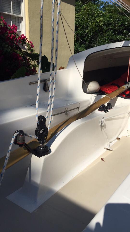

So this is the original mod where I flipped the cleat vs the whole new setup that eventually came of all this...
Basically, the cleat flipped up did not help to much. On a reach, the angle would get too extreme, and an even worse situation would occur... You couldn't un-cleat without crossing the boat... Not very relaxing :shock:
I love the new setup (was a bit pricy but worth it). Basically, I can hold the sheet in hand now, or clamp it off if my hand needs to go elsewhere for a few. I put an auto-ratchet on the boom, which also makes it super easy to hold onto the sheet when I want to sail with it un-cleated (which is fun fun stuff).
