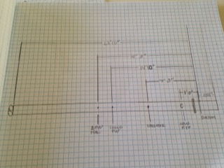

I did more measuring this afternoon and they are below. It looks like everything but the spinnaker halyard sheave is 5" too low. That makes me think that the mast was shortened from the hinge or bottom, but if I raise the mast step my shrouds will be too short.
A couple of thoughts, I could buy a piece of mast and replace the stub ~$50 + shipping, I could use a nice block of hark wood, free-cheap, or go all out and make something that would act as a mast Jack and have some adjustment to allow the step to be moved aft to help induce mast bend, a long garage project costing who knows.
So it only looks like I need to love my spinnaker halyard block and eye strap. Do I fill those holes with something?

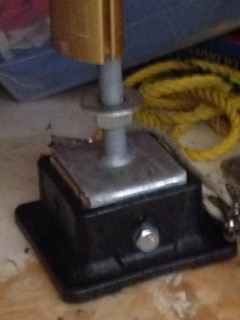

I spent some time at Home Depot today and came up with a $20 possible solution.
I used a plastic(ish) post base ($11) and an inverted galvanized pier block post base ($7) to act as the mast jack. I secured it to the same two holes on the cuddly floor. I will drill a 3/4" hole in my mast step casting to accept the threaded rod. By drilling additional holes in the plastic base I am able to move the mast step fore and aft in 1/4" increments.
Does anyone see any fatal flaws here?
