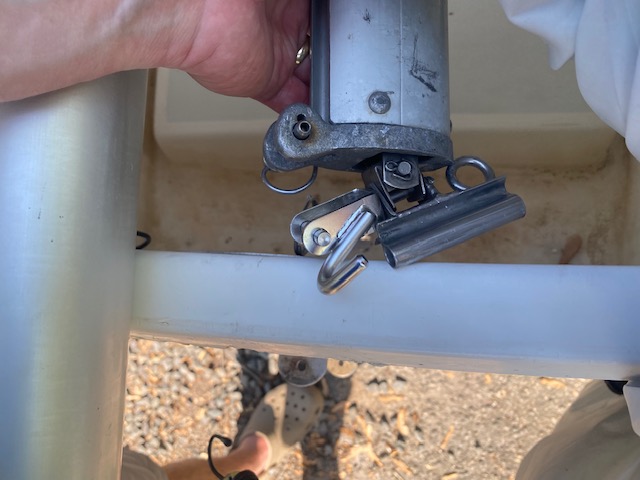

Is the reefing hook from D&R supposed to point towards mast or back towards boom? I am also thinking the existing pin may be better to use that bolt, as I am having a hard time finding out how tight to tighten bolt with out restricting boom mobility.
I honestly think a hook that slides on to a pin in the existing gooseneck tack pin may be best, but i think a new pin would be required. Or just screw a hook on to end of boom.

Postby GreenLake » Thu Apr 25, 2024 10:35 pm
welcome to the forum!
The reef hook goes on the boom - but on the end that is at the gooseneck, that is, closest to the mast.
The only requirement that I am aware of is that the hook can be inserted into the reef cringle and will hold the sail close to the boom and mast when the halyard is retightened. The sail will pull back on the hook as the reefline is pulled tight, so make sure that can't pull the sail out of the hook.
If it just won't fit on the boom as you have it, you could use any hook held to the boom with, for example, a short strap of webbing.
I don't know your setup and what the precise geometry of your boom is, or that of the gooseneck and the reef hook, and they may possibly vary with model and year. However, one way or another you should be able to fit either that hook (or something equivalent) so it is functional. It's not a fundamentally hard problem.
Good luck!

Postby sccresswell » Mon Apr 29, 2024 4:51 pm
IMG_9961 (1).jpg (62.76 KiB) Viewed 13721 times
Thanks for the welcome and response.
I know the piece goes on the end of the boom closest to the mast, but was curious if the hook itself should be pointing toward the mast or back towards the boom. I have it now (pictured) towards the mast is this right?
Secondly, is it imperative to use the bolt and lock nut that came with the hook? I tried using it but had a hard time getting it tight enough but not too tight so as not to inhibit the free motion of the boom back and forth so just used the same clevis pin and replaced with a new cotter pin.

Postby GreenLake » Tue Apr 30, 2024 1:33 pm
I think you're fine with a clevis pin, if the function is to act as a hinge.
The reef cringle will be pulled up by the halyard and back by the action of the reefline pulling on the (new) foot of the sail. In theory that means that the hook should oppose that combined force and pull toward the mast and down.
That would argue for placing the hook so it angles towards the middle of the sail.
In practice, as long as you can get the hook inserted and the sail tightened up again, I don't think it matters. I've even seen boats with double reef hooks, like a T where each wing is a hook.
If you find reefing awkward and you are able to reposition the hook and it improves, I'd go for it. But key would be to practice putting a reef in (on the water, not just at the dock).

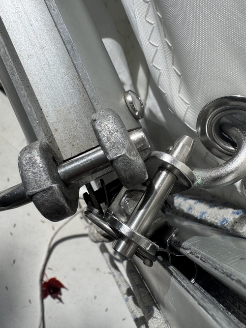

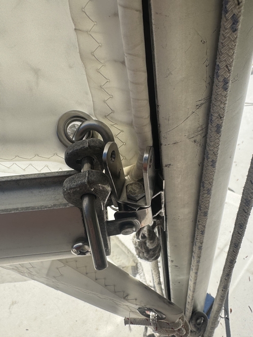

Hoping someone can help. On our boat, the gooseneck and reefing hook are interfering with each other badly. I tried mounting the hook on both port and starboard sides, but in both cases, it’s making hard contact with the gooseneck fitting, which just doesn’t seem right.
I’ve attached a couple of pictures... does anything look off to you?
Thanks in advance!
