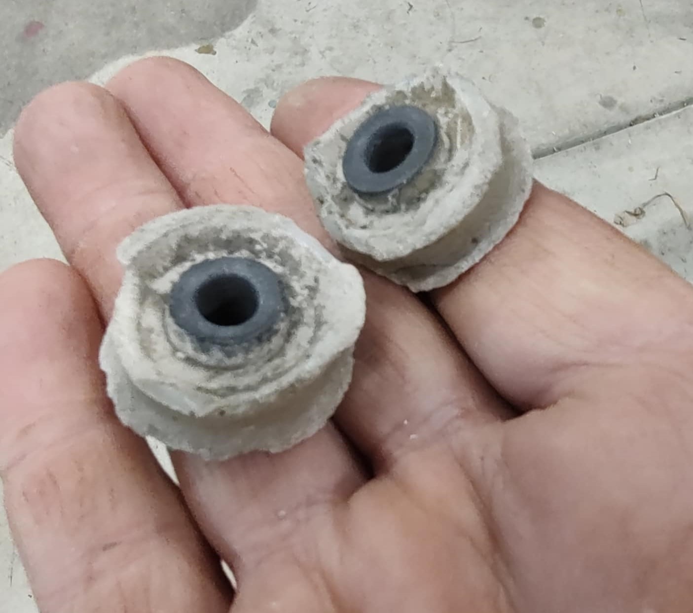

Also yesterday, I took a good look at the mast and all the hardware on it, and discovered that the masthead sheaves were completely shot:
And several other sheaves have a similar appearance.
Fortunately, these little plastic sheaves are pretty cheap, if you buy just the sheaves themselves, rather than the entire masthead assembly. Just have to drill out the rivets holding them in.

Running rigging, but more so the sails, are "consumables" on a boat, but you know that. Like tires or brake pads on a car. They have a definite lifetime. As do, incidentally, the wire stays. Please inspect those carefully for hints of rust at the terminals and if they are not the 1/8" upgrades, that would be an upgrade to go for. The 3/32" originals were undersized.
I "replaced" the rivets on my masthead sheaves with stainless steel clevis pins of the same diameter. An easy fix and the pins don't require drilling out, should the new set of sheaves require replacement.
