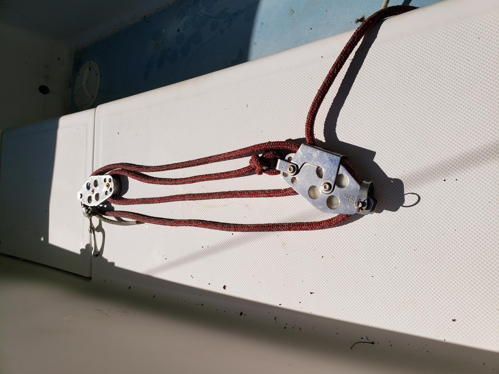

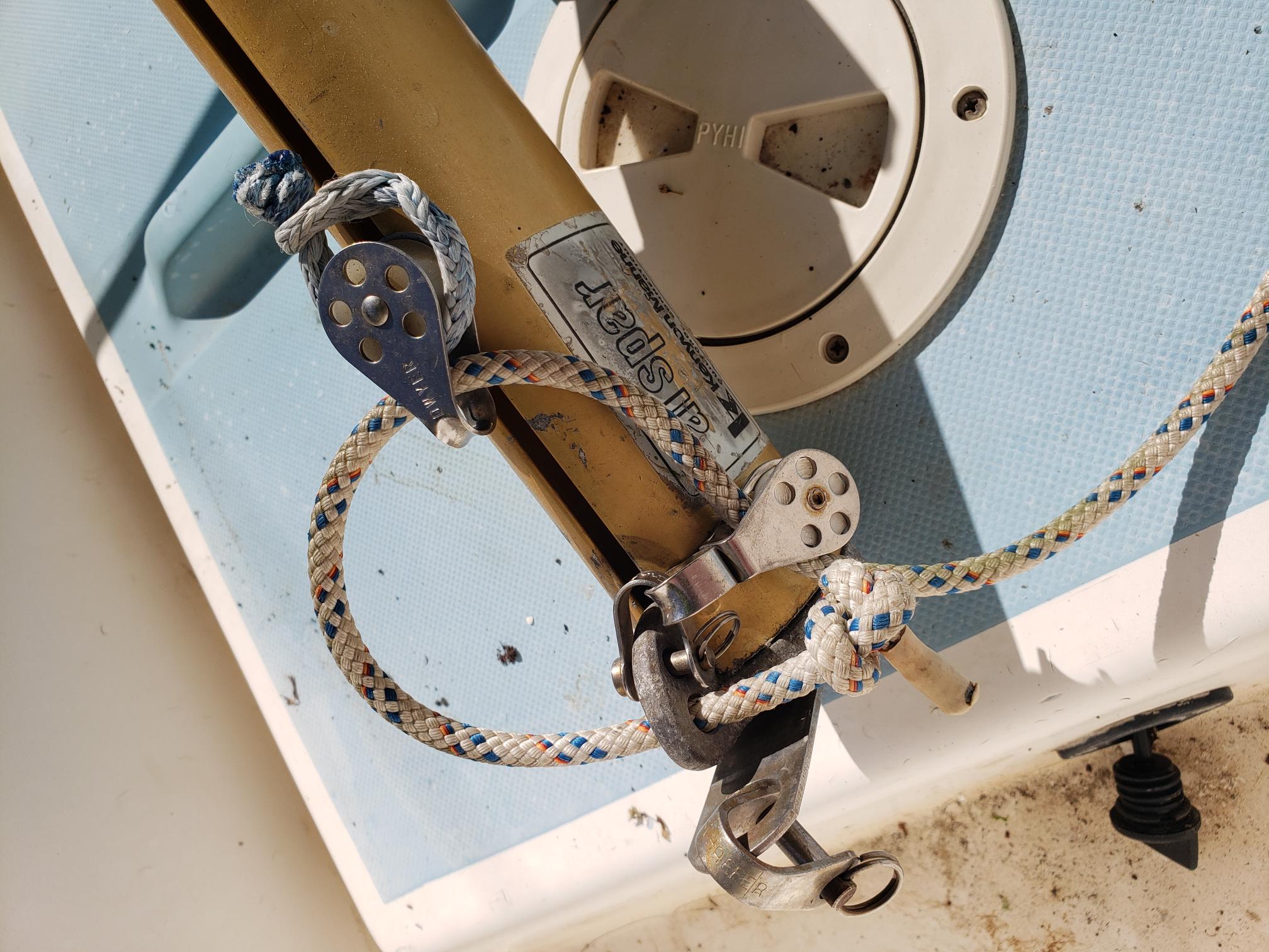

Hi,
New to the daysailer and sailing.
I have looked in the book provided by Roger and am having trouble identifying these components.
Anyone help identify..
1. Set of blocks that were in the cuddy.
2. Blocks on the end of the boom and a shackle..

Postby GreenLake » Sat Jun 01, 2024 6:51 pm
At the end of the boom, part of the rigging is for the end-boom sheeted mainsheet. There may be some other blocks that are used for reefing and or outhaul.

Remember, you'll find many small differences in rigging as the class rules do not enforce a standard. If you get the same result with a slightly different configuration, that's OK.
The second item is the poor man's version of a boom vang originally shipped with the DS.
Here's a discussion of a better boom vang. And some pictures:
