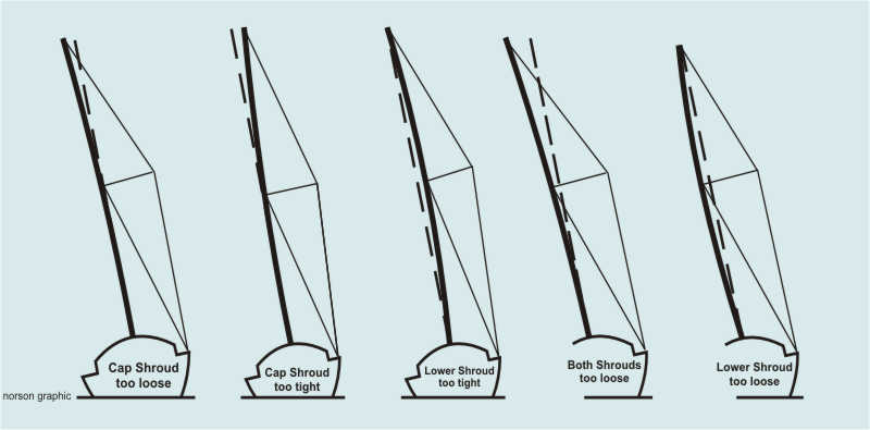

In boats that do nor have swept spreaders, the shrouds are all "in plane". The function of lower shrouds would be to limit sideways movement at the point where they attach. Without them, a gust would push the tip of the mast leeward with the attachment point for the "uppers" being the pivot, the mast below could curve slightly to windward. With them, the mast can't move that way, but the tip still gives, so there would be a bit stronger bend.
When you have swept-back spreaders, their normal action is to push that point of the mast forward, leading to a bit of mast bend.
http://www.sailingbreezes.com/sailing_b ... ll0800.htm
As you can see from the diagram, if you increase the tension in the leech of the main you can increase the bend.
With lowers attached so that they also attach aft of the mast, you would limit that mast bend, because the lowers would have to stretch as the mast bends.
This leads to the question of whether that is both necessary and desirable in a boat like this. For the standard, class-legal DS it is certainly nothing that is recommended. Would it be needed for a different (slimmer?) mast profile? I'm not a marine architect, so I can't know for sure. However, the fact that you say that your Uppers don't read the mast head means that there's a bit of unstayed portion of the mast at the top. That means, your mast profile can't really be that much weaker, or it would snap off. If you accept that reasoning, then you might conclude that you could live without the lowers.

- The fore/aft bend is to shape the draft (curve) of the sail, at the extreme you want the middle of the mast to go forward and the tips (mast head and deck partners) to go aft, curving your luff. Having another shroud attached to the lower third of the mast (at the crosstrees) does nothing to change the fore/aft bend, if anything it hinders bending the mid-mast forward.
- The leeward bend is your "shock absorber" for gusts and heavy wind. Normally, you do not want your upper mast bending to leeward at all, but if there is a gust, then the upper mast (above the hounds.... top attachment point of the shrouds) will fall off to leeward, automatically spilling some wind rather than overpowering the boat. What is "overpowering?" Well, that is when the boat starts heeling over more than is useful to drive the hull forward.... more sideways power than forward driving force. So does the lower shroud affect the leeward bend? Only marginally, it keeps the mid-mast around the crosstrees from bending off, but that doesn't bend off with a normal rig either - the spreaders hold it in place. Most of your lateral bend is in the top of the mast, above the hounds. Makes sense, that's where most of the gust's power is, up high! So I don't see where there's any advantage with lower shrouds for the lateral bend.
-I'm not going to explain all the physics of sailing here, but suffice to say that sailing is all about balancing forces. Analogy - playing the violin. You play louder by bowing harder (pressing the bow harder onto the strings), but if you ONLY do that then you'll get a horrendous screech. You need to balance your bowing with fretwork, your bowing angle, counterbalance with your chin, etc. Same with sailing, it's not JUST about windforce and how much sail you have up. Too much sail/force at best will result in the boat skidding across the water to leeward and at worst in a capsize. Balance... The boat is designed for a fractional rig, and to spill wind if it gets overpowered. These were the compromises made to have a boat that is both fast and family-friendly. Take a look at the THISTLE design for a counter-example. They are achingly beautiful boats, to the point that I get tears in my eyes when I'm around one (I tear up about strange things!) - 17' LOA, 6 foot beam, about the same as our boats, unballasted, fractional rig, and THREE sets of spreaders with diamond-stays. Pure racers, uncompromising. That mast will NOT bend to the lee, every ounce of power goes into the hull. What do you do in a gust? Hike Harder! Takes an agile crew, two at least, usually three. (By the way, the Thistle mast does bend fore/aft, but that's for draft). Anyway, I bring up the THISTLE specifically because that's what you do (multiple spreaders) if you want a stiff fractional rig on a 17-foot unballasted boat.
