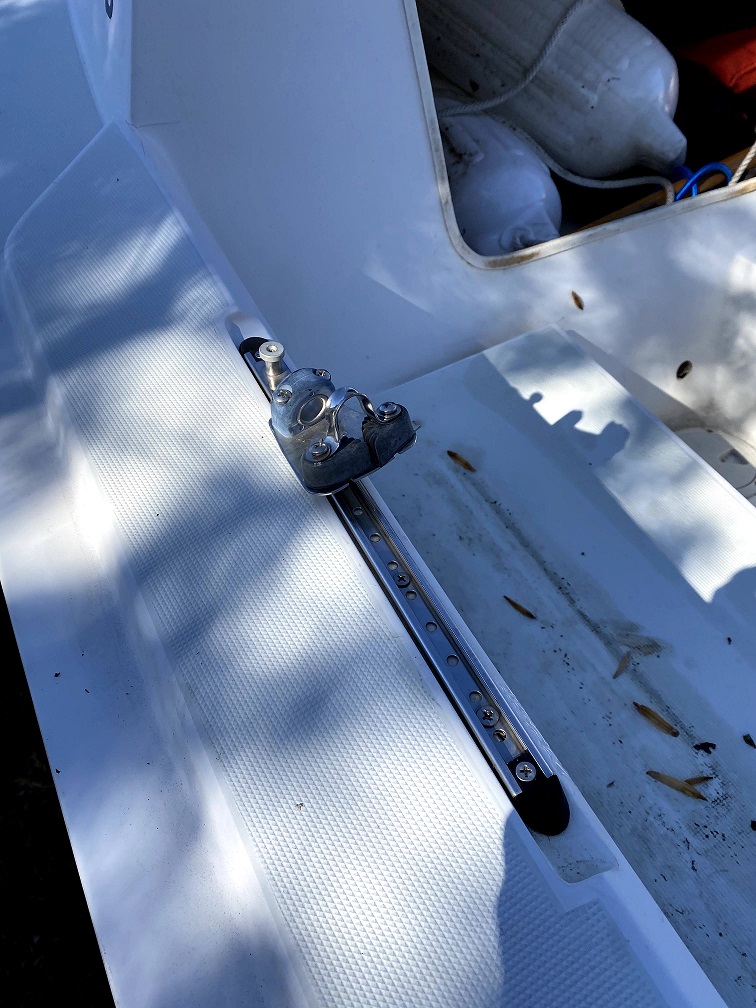

First change is replacing the jib cam cleats. I was thinking that I would copy Greenlake's setup which seems ingenious. So i'm planning to install inspection ports in either side to get access to the rail to back with a plate, then I would replace the existing rail with a harken rail and jib cars, then use a 57 Ronstan ratchet block on each (or 40, I have to see what the diameter of my jib sheets is). I would then angle some cam cleats on the centerboard trunk.
Questions:
1. Do i need to replace the rail? They seem fine otherwise. Is there a way to put just new jib cars on and attach a ratchet block?
2. How big of an inspection hole do I need? I was thinking 4", but I have some waterlogged foam in there, so maybe I should think about 6" so I can possibly get more access in case I want to replace the foam?
3. This is dumb, but which side of the cam cleat needs to be angled upwards? Is it the side closest to windward? Or the side where the jib sheet enters the cleat? As everyone can probably tell, i've read enough to know that other folks are angling the cleats, but don't have good enough knowledge around the 'why'.

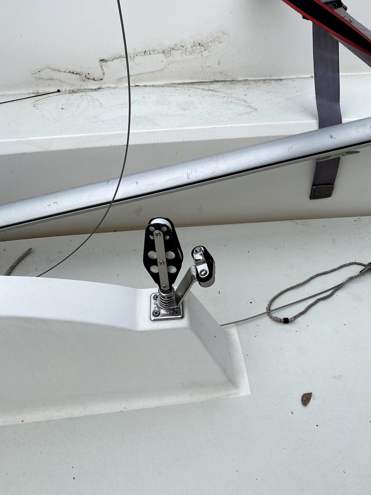

Second objective is replacing the main sheet blocks. After reading Green Lake's argument for ratchet blocks, i'm sold on the need. However I don't have a great understanding what the ideal setup is. Do i just need to update the boom block with a ratchet? Or should i update the fiddle block that stands up on the centerboard with a ratchet fiddle? Should I do both?
I really don't want to mess around with the swivel base, so if there is any way to avoid that - it would be ideal. Does anyone know if there is a swivel base with the same screw/bolt pattern ? I think i might have seen in the forum that the Harken 140 maybe is a direct match?
In an ideal world I would replace just the fiddle with a ratchet fiddle, unscrew the eye strap that sits on the cam cleat currently, and leave the boom block as it seems redundant to have two ratchet blocks on the main sheet. However I have no issues spending the extra $100 or whatever if it makes sailing safer or more enjoyable. I capsized a hobie with my then girlfriend (now wife) about 10 years ago - the last words I heard were 'I thought you said you knew how to...'. It took her another 10 years to get into another boat and this time around i'm very interested in not turtling another boat with her in it.

The track could be left in place, if you are able to fit whatever replacement blocks to the existing cars (or get a different set of cars that can be modified). In my case, the cars had a "loop" that could be opened from the back, so it was easy to switch out the blocks. The cars on your track combine fairlead with cleat. Your photos do not show the base, but it would be unlikely to have a convenient attachment point. If you can find the same track (or style of track) and either get replacement cars, or get one that has different cars that you can repurpose, then you should be able to keep the track. (Getting access to the end of the track to fit a new car may also depend on whether it has a cap and whether that cap can come off w/o dismantling the track).
Now, my setup requires cleats on top of the CB trunk. I've angled my cleats up towards the windward side of each. I don't use "keeps" on the cleats - there's a whole discussions somewhere why not, but you've probably read that already. Matter of taste & style that.
I have end-boom sheeting on the main, you seem to have center boom sheeting. In my case, the block at the center of the boom is a single 90 bend. I put a ratchet block there and it worked fine. KC put a second one at the end of the boom (also 90 degree turn). I would, if I felt the need for it, so far have not. In your case, I assume you have a fiddle also on the boom? Or is it a single block with a becket? In the latter case, you would just replace that one with a ratchet block. If it's also a fiddle, or a double block (two parallel sheaves) your plan of replacing the standup one sounds fine, if you can source the part and make it fit.
However, you may decide that you'd rather prefer end boom sheeting, in which case, don't prematurely upgrade the existing setup.
Inspection ports: always make them as big as you can fit. Esp. if you expect to use them for other purposes.
