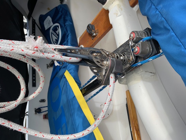

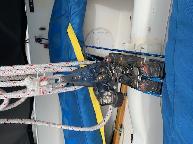

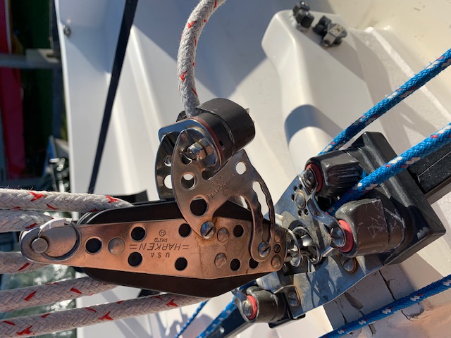

Not ready to remove & replace the existing traveler system, but have been looking at options because the more I sail the DS1 the less I like the existing Harken down release cam that is built into the lower block... had a fun windy day sailing last Sunday and it took some effort / concentration to get the main sheet to released.
Here are some pictures of my existing set up
I've not been able to find a block that would attach to the existing traveler car that has an "up release". New to hardware searches, but Harken does not seem to offer this. Other vendors I might search?
I did find this traveler replacement as one option, though since my traveler is pretty old I would need to do some double checking that this would work with other parts of the traveller. https://www.westmarine.com/buy/harken-- ... cordNum=21
I would then need new blocks, as the cam does not seem to be removable from the existing blocks.
Any thoughts are always greatly appreciated :D

Have you tried adjusting the bracket which the cam cleat is attached to? I owned a Rhodes19 which had the same setup for the traveler and was having the same problem. When the wind picked up over 15 it was hard to lease the cam cleat. After adjusting the bracket it did help but I was still unhappy with it so I called Harken and they sent me a new cam cleat base at a larger angle and it fixed the problem. You can buy these angles at West Marine. Harken sent me 2 of them and I still have 1. It's yours if you like, I won't ever use it. John

John thanks for the reply. I will first make the adjustment to the bracket so that the cam points up at a better angle.
When I got the boat in the spring and saw that the main sheet released down, I thought that did seem like a good idea and tried to remove the bracket / cam from the block and see if I could just flip the entire bracket / cam over and have an up release. While I got some of the screws out (angle adjustment screws) I could not completely remove the two other top screws from the block After much cussing I tightened it all back up and left the angle of the bracket the same as the previous owner had it set to.
The toughest part of this was the reattachment of the block to the traveller car, it needed "three hands" (only had two) to press the clock down on the spring / car, get the pin through, and then the circle clip in. I'll get a friend to help next time.
Do you have a picture of the new cam cleat base? Is it something like this wedge? https://www.westmarine.com/buy/barton-m ... cordNum=14. I am better with pictures.
