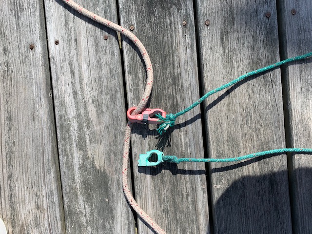

Also looking for help in identifying what maybe the barber haulers that the previous owner left behind in the "bag of extra parts
... think these are my barber haulers ? One clip is broken. The part say NAB and Made in England, but my google search didn't find anything.

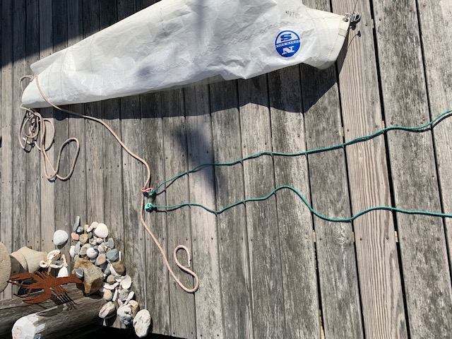

PS: you don't show the end of the green lines; they should be about 6' long. If much longer, they'd be for something else.

Think I am going to first try the buntline hitch and have found that Harken sells rings. You mention the friction on the clips from the sheet; the clips that came with the boat (look very old) have a slight groove / polish mark on the inside that has been worn down over the years from the sheet rubbing through it. Yes the green lines are almost 7 feet long, and I think the boat has the hardware. I'll go look tomorrow.

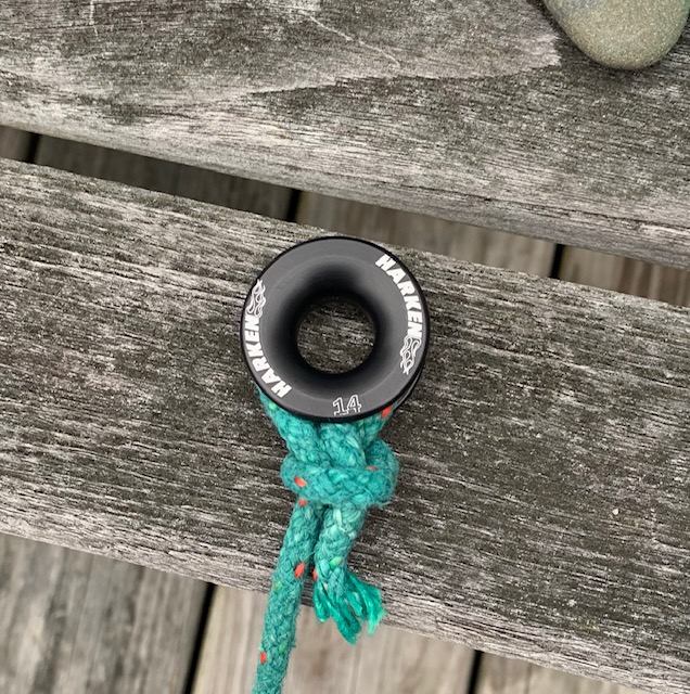

GL thanks. I am going with the 9/16 inside hole diameter which is the 14 mm ring.
Also went to the top of this thread and now see that the original picture of the ring / splice shows the number 14 on that ring.
Yes understand the outside ring groove width comment for the line.

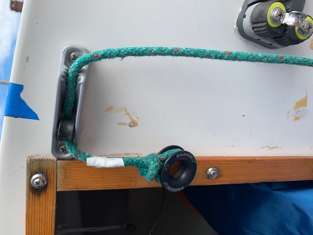

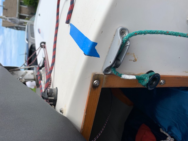

Wanted to provide an update and some pictures on adding the barber haulers (in haul) for my jib sheets.
Used the Harken 14mm ring, tied a buntline hitch, there already were clamcleats installed on the boat, and a friend at my club shared with me this link to North Sails Tuning Guide where on pages 4 & 5 North talks about where to mark location on top of cuddy cabin. https://www.northsails.com/sailing/en/r ... ning-guide
Sailed several times now, still learning, but definitely see some improvement.
