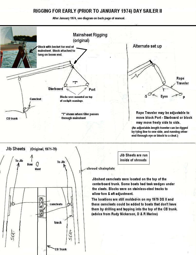

A 1978 Day Sailer would have come from the factory with mid-boom sheeting. However, there are some advantages as stated to the older end-boom setup. Disadvantages are need for longer mainsheet and all that rigging aft.
Anyway, here I the diagram from the Expanded DS II owners Manual that I created, it shows variations on the Crosby and other end-boom setups.
Early DS rigging Main sheet
Main-Jib sheets2.jpg (122.07 KiB) Viewed 10919 times

A rope traveler across the stern with end-boom sheeting is also popular with racers. My diagrams (sketches?) show some options for those setups.
