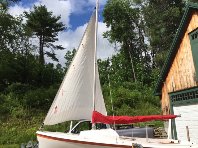

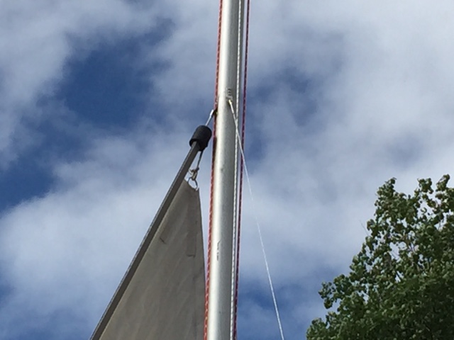

Postby dpatrick » Mon Jun 29, 2015 3:31 pm
ok here's some photos of what the setup is right now
Greenlake, that makes sense for sure! I think I could reinstall a pad eye and block in the original location below the tang, then take the block off if I want to put the furler on. The forestay is part of the furler so I couldnt move it from its current location, thats why I had to buy a new stay for the regular jib

Postby GreenLake » Mon Jun 29, 2015 6:11 pm
I know about the way the forestay is built into furlers. While that means that you need a "real" forestay when you don't want to use the furler, it doesn't mean that you couldn't attach the furler about an inch or two higher on the mast. You would just need to have something that adds the additional length, so the tension comes out the same (and you would still not be able to mount forestay and furler at the same time, but you were not planning on that).
However, if the furler works where it is, with a pad eye added and as long as you remove the jib-halyard block (and forestay) whenever you rig the furler, then, why not.

Postby ldeikis » Thu Jul 02, 2015 4:27 pm
dpatrick--
I'm unfortunately at home instead of out on the water to take a look for myself, but I wonder if there isn't room to mount the OEM jib halyard block slightly lower than stock and still achieve a taut halyard? Seems to me that even when the jib is strung snugly, there's a little bit of halyard coming back down from the block. Again, I'm not at the boat to see it, but if that were the case you may be able to mount the eye strap to the mast low enough to clear the furler, and just have the jib tuck into that triangle. I don't have any experience w/ furlers, but I'm interested to see how you solve this.
