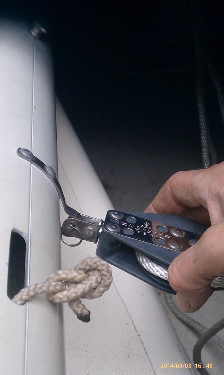

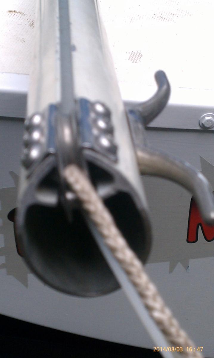

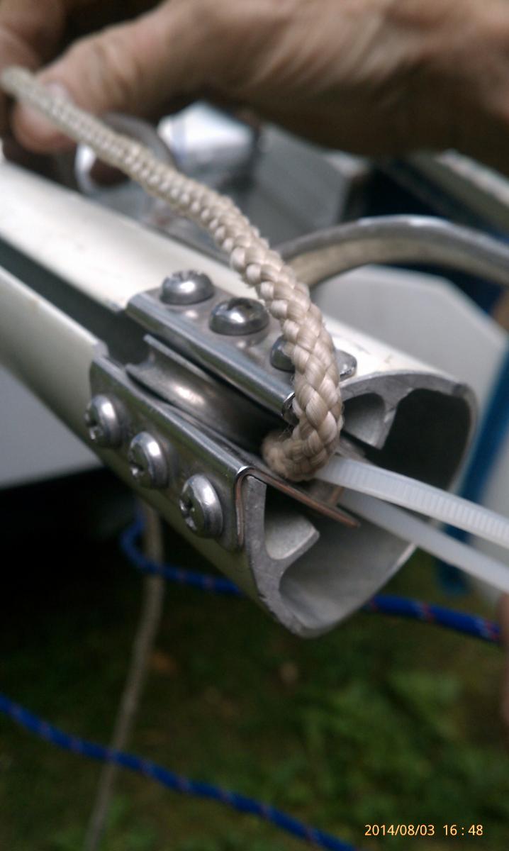

Truly sorry to be a nag on this, but I just don't completely understand what modification would be best to make on this boat. It appears to me the Spindrift manual depicts mid-boom sheeting with the connection to a traveler. Several people have suggested that a boom vang would be better (if limited to one or the other). The traveler arrangement appears to be a little harder for me to grasp using it single handed and having to move up to the cuddy to adjust the jib. I tried sailing with both last week and affixed a temp traveler and did not feel I could even raise the jib in the light wind.
I am including some images of my boom end to show the internal pulley I can only imagine is for running the outhaul down inside the boom and out of the slot by the mainsheet block. I do appreciate the images and the details shown on your boom. I know I want to add a topping lift, but 3:1 mainsheet block seems inadequate in even moderate wind. I took on quite a bit of water on my 3rd sail when I could not release the mainsheet tension (pulling down out of the cam cleat) soon enough while my son loosened the jib sheet. I would think a strong boom vang (more than 4:1) would put a lot of torque on the boom if not handled properly and sometimes quickly? Not sure what direction to take here. Thanks for the help.
this is the slot in the boom I've run the outhaul through
I have a small block temporarily hang with a ty-rap
another boom end image

Your middle image (despite the caption) seems to show the center boom block. It is hung from a boom bail. You could rivet a similar bail at the end of the boom or through-bolt a U-bail like the one I posted earlier. Either one would work.
If you use a ratchet block instead of your center boom block, then you don't need to cleat the main sheet and can hold it in your hand. I use a Ronstan 55mm Orbit ratchet block set to auto ratchet. In a recent review in Practical Boat Owner it was shown to have double the holding power of other blocks for the same purpose. More holding power means that the pull on the mainsheet from the sail has to be double to overcome the force you apply on the working end of the sheet. Because the ratchet feature engages automatically, your sheet will run free whenever you don't provide tension on the working end. One downside of the strong holding power is that the block will chafe the sheet. While the effect is visible, it's not something that worries me - it will take several more seasons before I need to swap my main end-over-end because of that, and even longer for a full replacement.
The key point is that with a ratchet block you separate the effort of trimming (making an adjustment, short term pull) from the effort of holding (long term pull). I find that I cleat the main a lot less with the ratchet block and that holding it in my hand for handling gusts in higher winds is feasible and no longer as tiring.
One upgrade I would make is to switch your swivel cleat so it releases up, not down. I still use the original swivel block that came with my DS and it releases by pulling up. It is not any harder to cleat it, but definitely much easier to uncleat it. With other swivels I've found myself "trapped" with not being able to position my hands in a way that I could pull the main out of the cleat.

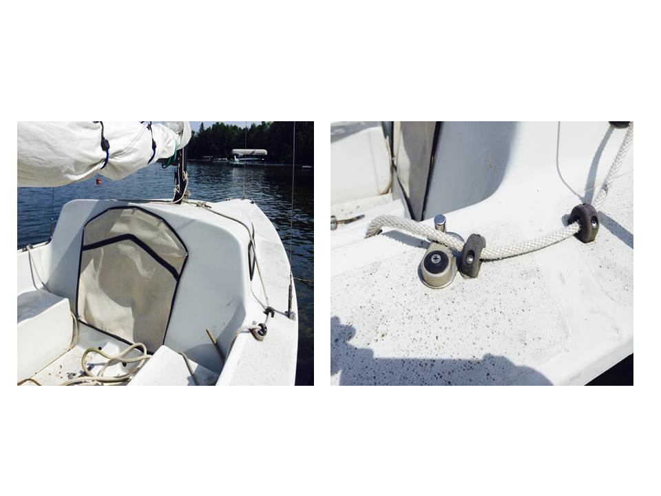

The cuddy mounted cleats that you have could be used

Here's another image of the cleats on the cuddy.
1841
The image shows only the starboard side. Shown are the port side Barber hauler lead to the windward cleat (black) on the starboard side, and the Spinnaker halyard (yellow cleat).
There's also a horn cleat that came with the boat and may have once been intended for a halyard cleat. (Those are now on the side of the mast, as seen in an earlier picture - I see little use, in a boat as small as the DS, to lead the halyards to the cockpit...).
Also visible near the bottom of the image is the the starboard side barber hauler. The photo was taken with the haulers slack (the lines point down; when they are tight, the tension brings the haulers horizontal).
