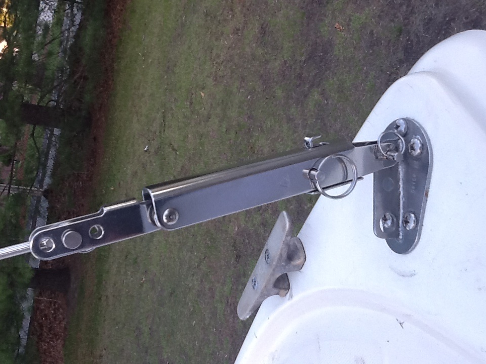

If you are going to trailer sail it I would recommend the forestay with the quick connect lever. Works upper slick.
TBone
Quick connect on the boat
D&R picture
