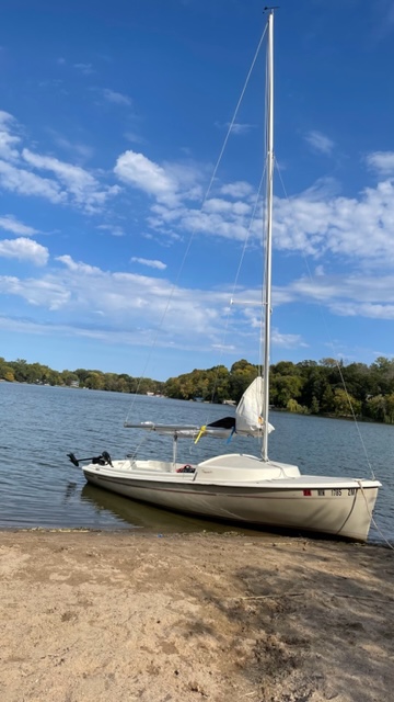

I have a DS2 from 1985. The metallic band is just a coppery decal, you should be able to scrape it off with a little heat gun action. Or you could just paint over it again.
Mine has rubbed off in places:
