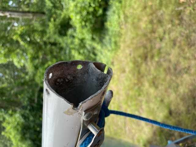

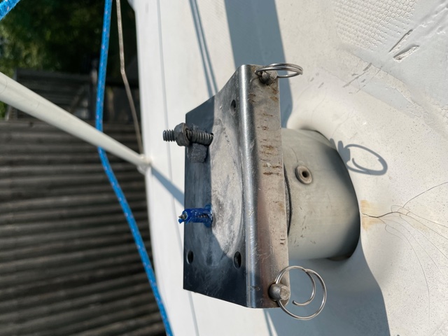

First post and I'm borderline about to walk the plank. The first three hours into owning my new (used) DS2 17 foot ODay, I snapped the tabernacle. I was trying to step the mast solo, and had the mainstay on but couldn't get the ring into the pin and it slipped, and...well...the mast flew backward and bent/snapped the tabernacle. I have included pictures, and I'm hoping that the damage isn't too bad. I have a Marine shop that has a tabernacle I can replace with, I'm just afraid there is more damage than a novice like me knows about. For example, the picture of the mast seems like it's chipped where they would have to replace a part.

OK, so deep breath! On a Daysailer, like most stayed marconi rigs, the stays are there to hold the sails up, the mast is there for pretty and to give the stays someplace to attach to on the top end. So don't worry about the chip in the bottom of the aluminum tube, that's cosmetic and also sitting in a place that has no real stress on it, below the rivets. I joke about the mast being decorative, but the fact is that it's mostly in compression: the stays pull it down into the bottom of the boat (mast step on the keelson), the side to side and fore/aft forces ON THE MAST are minimal, relatively speaking. Force ON THE STAYS is another story, they're carrying the force of the wind on the sails to your hull. So, you just have to make sure that there is a decent connection between the top and bottom parts of your mast, so that the compression force (downwards) doesn't go off somewhere else besides directly down to your mast step at the bottom of the boat. Got it?
So, let's discuss what looks broken. As I wrote, don't worry about the chip in the heel of the top part of the mast. The forces from mast to tabernacle are carried by the rivets holding the the dark grey "shoe" at the bottom of the mast, which screws to the tabernacle (the bolts you bent). Obviously, you need a new tabernacle, I have a spare if your local marine store tries to gouge you. More importantly, you chipped the back of the "shoe." Is there enough "meat" left on it to make a good connection between the shoe and bolt? In theory, you could get away with just the one bolt (the forward one), but it's good to have belt and suspenders (i.e. I wouldn't sail with just the one). If there isn't enough left of the aft hole in the shoe, can you get a good grip for the aftmost bolt using a washer (above the shoe)? If the answer is no to the above, then I'm afraid you'll need a new "shoe" ... talk to Rudy at D&R. Replacing the shoe will involve removing the old rivets and putting on new rivets, Greenlake can guide you better than I. I THINK I might have those shoes in my odd parts box, they don't fit my mast and may not fit yours. We can cross that bridge when we get there.

I live in MA, and already spoke with Rudy on the phone at DR and will be at his front door when the shop opens tomorrow. That being said, I really appreciate your offer for the spare parts. I have detailed videos and pic on my phone so I'll know more once I speak with DR in the AM. I'm really glad to hear there isn't major damage- and yes I think I will most likely need new "shoes" for the mast heel- hoping Rudy has those as well. That chip is on the bottom end of the mast where the Tabernacle mount goes- I'm hoping that a new shoe can be put in despite that chip was my concern.
