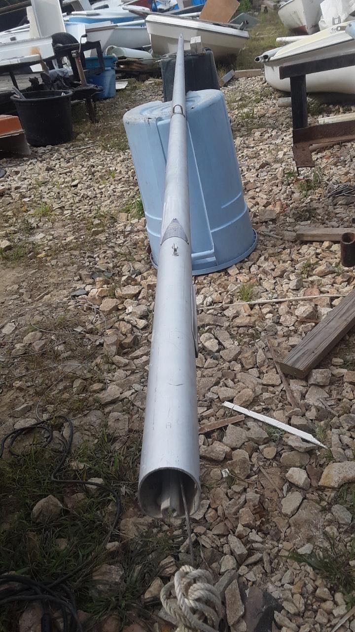

He sent me some images of it and I don't think it would fit into the hole on the cuddy unfortunately. Unless someone can correct me here...

So I told the guy I'd like to buy the Proctor mast after all. If I can make it work, it does seem like a really nice mast for. good price.
Now, Does anyone have an opinion on replacing the mast step vs adapting the Proctor to work with the original system? Seems like it might be easier to replace the male mast step rather than try and fit the female receiver...

Pictures?
Looks like the mast you are getting is open on the bottom, whereas normally it's capped by some kind of casting. I guess it's possible to lay up some fiberglass so it forms a "cup" to receive the mast, allowing for even transfer of the compression load. I'm guessing a bit, but anything that has a solid 3/16 to 1/2" of laminate should be strong enough. Alternatively, take some metal plate (aluminum) and just lay up a collar.
But without a picture of what is there today we're guessing wildly here.
