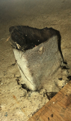

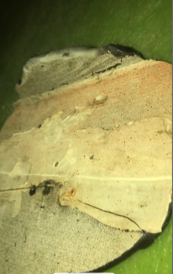

I just bought an old rebel 16 and it turns out the wood that supports the mast has completely rotted away. There is a screw in deck plate close enough where I should be able to replace the wood and fiberglass it in. It looks like it was originally just a 2x4 that was fiberglassed in but I don't know for sure. I have done some minor fiberglass work in the past but nothing like this. Im just wondering what the best way to go about this repair is. The first picture is at the bottom where the wood has rotted and the second picture is the top. Any help will be appreciated!

Frankly, I am a bit unsure what your photos are showing. The bottom one, I don't even have an idea of the scale. The top one, my best guess is that we are looking upside down. It seems to show a fiberglass collar (or partial collar) for the wooden mast support which seems to have rotted very thoroughly. I assume it would have extended in what is the "up" direction of the photo as presented and presumably rested on something ("above" of what we can see). Is that correct? (Is that "something" the one shown in the second photo?). What is the distance between the two? Or how long was that post?

Sorry about the picture quality it is a little hard to maneuver my phone in there. You got it right though, the bottom part looks just like a 2x4 piece of wood and it extents about 3 inches up from the bottom of the boat. The piece on the top is a lot bigger, about half a foot in diameter and only about half an inch thick. There is a 2 inch gap between the 2.
