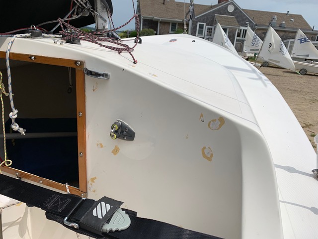

My SLI DS previous owners have had different layouts for deck hardware over the years, with the next owner changing the layout, moving / removing hardware.

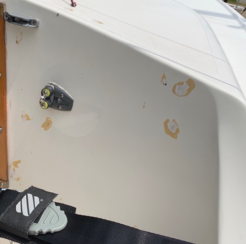

There have been various patching efforts to fill the holes left behind. Some sort of hard filler that is now a rough, yellow / golden brown and usually covered with a dab of something white (too much texture to be paint). See pictures as an example.
Everything seems sealed, but I'd like to make these patches look better, not be as conspicuous. There are a lot of patches, e.g., face of the cuddy, foredeck, around the mast, aft with various spinnaker block / cleat set ups, etc., etc.
All of the patches should be sanded down some, but then I don't know what to cover them with, and using something that might match OK with the white gel coat and sanded smoother.
Any thoughts / suggestions ?

Get yourself a gelcoat repair kit. The color of your deck will most likely be an off white, so you might need a small amount of some of the coloring agents to get an acceptable match. The kit will have instructions on how to achieve a good repair. If the damaged areas are so extensive that one kit looks like it might not be enough, get some plain white gel coat paste from the same brand, should be compatible with the tinting agents.
If you tape the repair (or apply a stiff plastic foil, like the old overhead projector ones - or a "window" from some toy carton) you may achieve not only a flush, but also smooth surface, saving sanding.
(If you have universal tinting colors for house paint sitting around, you could experiment; they might work in the very small quantities that you are likely to need to match an off-white. If successful, you win, if not, no big loss - just make sure to do a sample somewhere other than your boat. If it hardens and looks good when used as otherwise directed you should be fine.)

the yellow stuff may be some sort of epoxy filler. Epoxy will turn to a similar color when exposed to sunlight over time. You may be able to take a heat gun and heat it up to around 200 - 250 degrees, it will soften and with a sharp scraper or blade lift it off. Gelcoat can stand a lot more heat without damage. Our club DS had gobs of old yellow epoxy all over. The heat trick really helped. Then you can polish the gelcoat under and your repair area will be much smaller.
I picked up a little sander to get into the deck joint and I have found all sorts of uses for it. It is a detail belt sander, cheap and it works surprisingly well for jobs like this.
