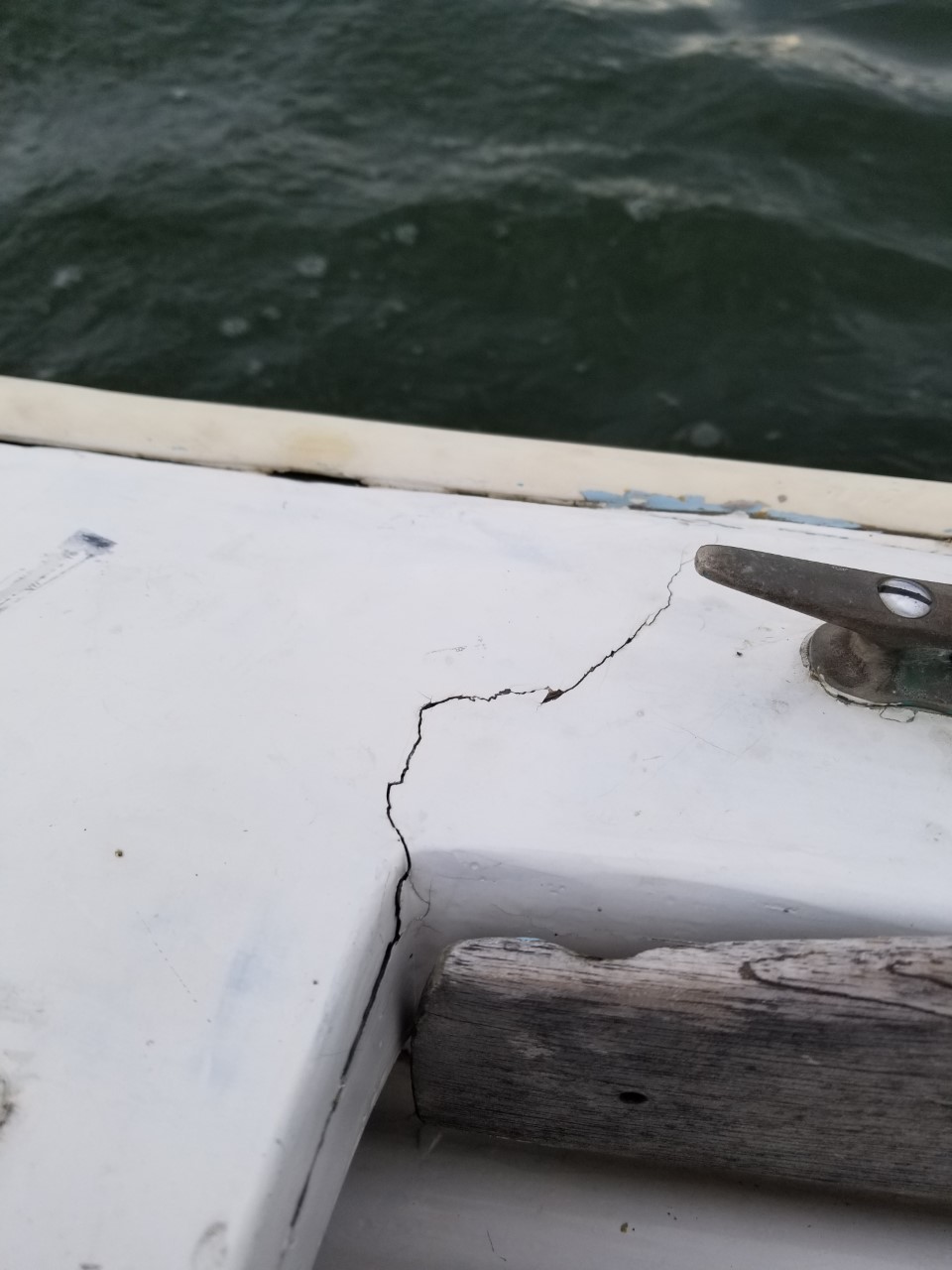

I want to do a few quick repairs to my boat before putting it in the water for the summer and hope that I can get a little guidance here, or at least prevent myself from doing something stupid. First, I want to Install inspection ports in the seats to remove and replace old foam. And then fix a few cracks that have developed at the back of the cockpit. Based on research on this forum and YouTube I am pretty sure I know what to do for the inspection ports. I do however have questions about the cracks.
My initial plan with the cracks was to use my dremel tool to grind out and open the crack up a little more, creating a bevel in the surface, maybe a half inch to one inch wide. Then using epoxy and fiberglass sheeting create some patches to layer into the cracks, sand and paint. For now I will just paint over the epoxy to give it UV protection with the hope of repainting the interior and topsides of the boat before next sailing season.
Alternatively, it has been suggested to me that I clean the cracks up with a utility knife and use 3M 5200 to glue the cracks.
I would be interested in hearing what you guys have to say about either of these options.

I'm assuming it's not structural, these cracks don't look very deep in your photos. If it's just surface, then I'd go with my favorite overpriced fix-it tube: MagicEzy 9 Second Chip Fix. Ridiculous price, but it works great. Three tips if you do get it:
You don't need a lot, which is good cuz the tube is tiny, tiny.
Lightly sand the area, put down the goop, smooth it with a real spatula, not the tube.
Set it with a hair dryer on low. Really does only take 9seconds, but with hair dryer, otherwise it doesn't set at all. Lightly sand afterwards and you're done!
21 bucks, fix it, go sailing. Of course, if the crack is structural, then it's a whole different ballgame. Go with your option 1, lay some glass cloth (or biaxial tape) down to strengthen. How do you know if it's structural? Me, I'd just try flexing it.. Press on one side of the crack, does it move relative to other side?

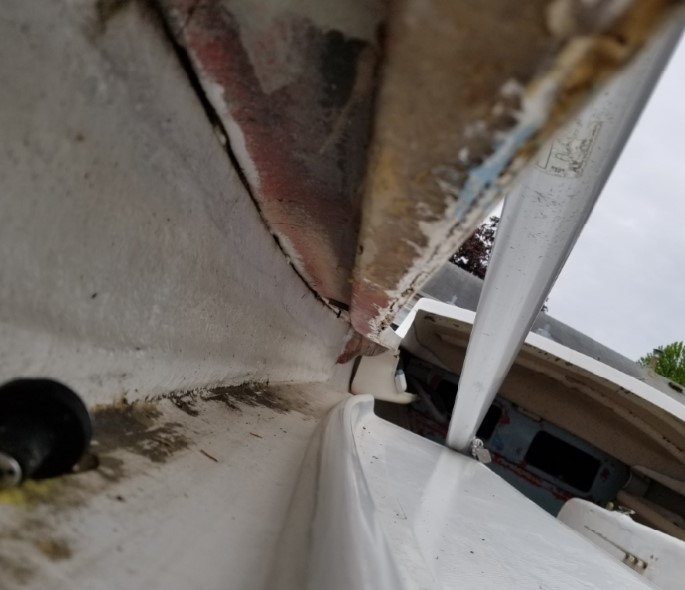

Thanks for the response. The cracks pictured in the previous post are both under tension. The two pictures attached to this post are of the same crack, one under tension, one not. These pics were taken while sailing.

I haven't come across that magic elixir. If looks aren't an option you can use Marine Tex epoxy paste. That's what my boating friends use for quick repairs of larger defects in the gel coat (on any size boat). That one should be relatively easy to get hold of.
If the crack is limited to the gel coat: gently widening it and then applying fresh gel coat in the crack would work. If not noted otherwise on the package, you will need to tape over the gel coat or the air will not let it cure. That's a good option if you can source gel coat (marine store).
If the cracks are structural, and it looks like they might be because that woodwork of yours looks like it's partially missing or otherwise not supporting the deck anymore, then you need to strengthen the affected area. (Might be a good idea, anyway). There's nothing that says that you have to do that from above/outside. You might lay up an L or even T shaped piece on your workbench (three, four layers) and then let it harden some, but, before full cure, glue it with epoxy to the underside of the deck - sand there first.
Alternative, lay it up on a sheet of plastic and apply it while wet - the former may be easier if you can get a stiff piece to conform - the latter may need creative solutions to support it while it cures, but would be easier to apply into the angle at the edge of the deck. In either case, inside needs to be sanded well.
If you find that part of the problem is that your transom deck is not longer supported, see whether you have room to add a hollow stringer, perhaps a pvc tube wrapped in glass and pressed into the deck corner from underneath while the layup is wet. That should stiffen up things.
If you do gelcoat on the outside, epoxy from the inside, you will have the benefit of making it easier to paint the epoxy without having to paint the entire deck.

Nate: Yeah, those cracks are deep, forget my Magic 9 second tube. Good stuff, but for surface dents only. You need to strengthen and re-enforce the area, GL has some great suggestions. And yes, the coamings (wood bits) in the DS1 are structural, that's why the bylaws don't let you remove them and remain class-legal. Talk with Rudy about how you can replace them. If you want to build something yourself, I'll be happy to draw up a template of my "back piece," since that's what you are missing. PM me.

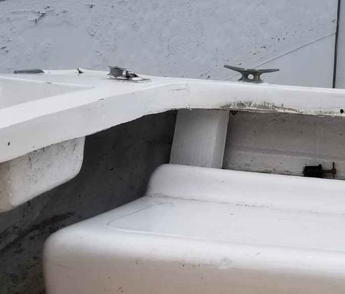

Here are some additional pics of the boat. For the coamings there is a piece of wood backing them on the sides which seems to be in okay shape. All of my screws were holding very well when I removed the coamings. If I am replacing the existing coamings and adding a new one across the back it sounds like mahogany is the way to go? Locally it seems like I can source mahogany, I was looking for teak but that seems more difficult to find.
You will also notice that it looks like wood has been added from under the deck to the seat. I am guessing to have my new "L" glued under the deck I will need to remove that piece.

For the kind of support "cheap" plywood is fine - sealed all 6 sides in neat epoxy and all holes individually sealed to keep out moisture.
That goofy support post was added there because without it, the deck is probably sagging. There are supposed to be a set of 3-4 triangular brackets underneath each of the side decks. I don't see those in your photo of the carlin. (On my boat they look like those wooden book shelf supports and go into the corner formed by deck and hull)
I say "supposed to" because mine look original, but you never know. Clearly some support is beneficial (even after restoring the strength of the deck laminate). If your boat predates the addition of those little supports or if they got lost, then you may want to add that "support post" back after you've done your repair.
That patch kit looks like it would work. Inclusion of "mylar film" indicates that it's not the air curing kind, so needs to be covered to set properly - mylar will make a nice smooth surface.

Correction: my memory is playing tricks on me. There is only one set of such supports at the forward end of the seats and clearly visible in your photo if scrolled. Nevertheless, the builder felt that some support of these decks was needed. With them weakened by damage, as in your case, some extra bracket/post in that location may not be amiss.
Re: Fixing Cracks
Postby jalmeida51 » Wed May 22, 2019 5:22 pm
The previous owner of Daysailer1 built by Rebel (1981 ) Put in 5 supports under each side deck. He gassed them in and he used 1/2" marine grade plywood. He also made coamings, these were made of 5/8" mahogany. He claims the side deck had a lot of flexing when sitting on the rail. He was afraid the flexing would lead to cracks where the side deck connects to the rear and forward deck. He also put a coaming of 5/8 mahogany to stiffen up the rear deck. I don't know if this was over kill but side decks and rear deck have no flexing. No Cracks
